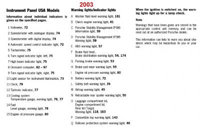

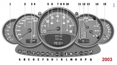

My 2003 996 Carrera 2 has a trip computer in the bottom of the central rev counter. The speed is displayed digitally at the bottom of the speedometer on the left. The trip computer is controlled from a stalk on the steering column. The trip computer displays various stuff such as: mpg, av speed, temperature, remaining fuel.
Is it possible to set the trip computer to show current speed? It shows most other things, but whatever I try I cannot get current speed. It would be useful to display current speed here as it is easily viewed.

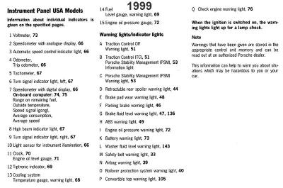

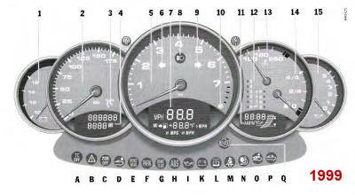

I remember driving a Carrera 996 in about 1999 and then there was a digital speed readout at the bottom of the rev counter. However, I can't remember if this car had a trip computer.

Thank you for your reply Loren. The layout that is shown for the 2001 car is the one I remember and the later 2003 layout matches my car. I thought at first my memory was playing tricks.
With my OBC there is a type of speed warning that allows a max peed to be selected and when that speed is exceeded the OBC shows just the max speed reading with an accompanying bleep. It would be great if the OBC could show a continually variable form to match the current speed of the vehicle and then bleep at the appropriate time. However, if that facility is not there I am not going to get it.
