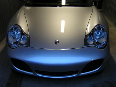

I put the 3M Clearguard on my new C4S and it turned out fantastic. You can see a line across the hood, but it is only visible when very close up. Here is a pic of my car...you can't see any lines. I paid $600 for mine. It was originally $699, but I knew someone who knew someone, and they tinted my windows at a discount too. So, $600 is average. I wouldn't think it's a DIY project though. Have a pro do it who's done many before....just my $.02
hey Jp66
On related,
but is that the rare silver, red & black Porsche emblem on your bonnet?
nice look great.
