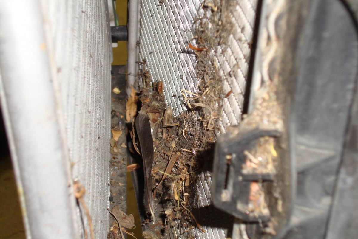

Ever cleaned the radiators? 200 is high temp at speed, there should be plenty of airflow to keep at indicated 180 temp when running at highway speeds.
As Ahsai indicates, lean fuel mix could cause higher engine temp under load and cause stalling.
post-30824-0-22349600-1373132725_thumb.j
