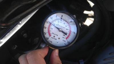

First, sorry but false alarm about excessive vacuum pressure earlier. When I converted my vacuum readings to BAR, I didn't realize that my vacuum gauge measures in in.Hg for vacuum but PSI for pressure. Thus, I converted BAR from PSI instead of in.Hg. In my defense, I did say I was a newbie in the topic of this thread. :)
Attached are pictures from my Actron vacuum gauge with the 996 at operating temperature, as well as a reference image to show the base reading. As you can see, I get about 14 in.Hg (0.474 BAR - for real this time) of vacuum at idle at 680RPM. When the vacuum gauge is T'd into the vacuum line attached to the fuel pressure regulator, the vacuum measured drops to 12 in.Hg (0.406 BAR). That puts it within the 0.4-0.6 BAR specifications from that 986 diagnostic PDF Ahsai provided.
Unfortunately, this means it is most likely leaky fuel injector(s). This makes sense, given the fact that one bank is running richer than the other, the low mileage of the car likely meaning it or its gas sat for long periods of time, etc.

That looks more like it. Be careful with aftermarket injectors, they are not always what they claim to be. There are firms that do excellent refurbishing of the injectors all over the country that will tell you quickly if one or more cannot be saved, but that rarely happens if the car is just off on mixture. I would suggest that while you have the car apart. do them all as you don't want to be doing this twice.

That makes a lot more sense. Your fuel trim numbers seem to suggest both banks are affected, maybe more so in bank 1 so I won't be so sure about leaky injectors. In addition to the techron cleaner I think it's a good strategy to wait and see till the CEL comes on again, which will make diagnosing the problem easier.
After reviewing all the data you posted I agree with Ahsai and do not think you have leaky injectors. Without having the car in front of me my hunch is you have 1. the 02 sensors connectors have dirt or corrosion 2. vacuum leak 3. unmetered air just after the MAF or at the exhaust just before the o2 sensors that is fooling the o2 sensors to command more fuel. If you look at your screen shots the o2 sensors are switching at 0.4 mV to 0.74mV and giving a lean bis or low voltage command to the DME it see that as the motor is too lean. The DME now commands the injectors to add more fuel by making pulse width longer. Also the fuel trim on your car is 24% and 19% normal should be no more than 10%.Before you start looking for vacuum leaks I would also revisit the TSB on the 02 sensors as it is a quick and simple test to see if they start switching at normal rate. If the connectors have any dirt or corrosion this could add resistance thus giving a lower voltage to the DME. Porsche hates to admit any fault but this TSB shows that 1999 was a bad year for 02 sensors.
