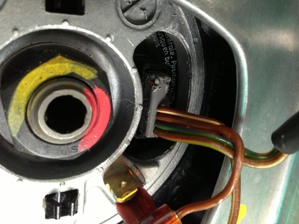

post-48205-0-48702000-1375291835_thumb.jpost-48205-0-48702000-1375291835_thumb.jpost-48205-0-48702000-1375291835_thumb.jAttached is picture of connector. It has four wires going into it. Two from center hub of airbag and two that can be disconnected

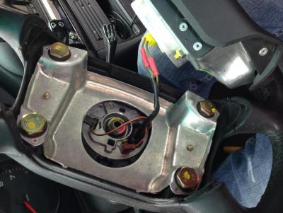

After consulting with electrical engineer, I decided that cutting two wires and splicing was a workable solution and I preferred to have the new airbag frame. The wires do not move relative to the other components within the frame, so I was not terribly worried about abrasion of wires. I used butt splices size 16-22. See attached pictures. I followed other post 28-horn-problem for disassembly procedure and was careful to disconnect battery. Repair went smoothly and so far appears to have solved

Your electrical engineer did you a real disservice. You should never use crimp connectors on anything that has to do with airbags or any on board computer systems. SRS systems are very sensitive to resistance and you are asking for trouble. Just the fact that you have made the wire longer by adding connectors is a big no no. Over time your SRS will light up because of an improper connection or corrosion. Most OEMs will call for a new harness if there is a cut wire or bad connector Porsche is one of them. BMW is one OEM that did approve of splicing however it must be soldered and covered with approved watertight shrink tubing. The connection you have made really concerns me for your safety.
