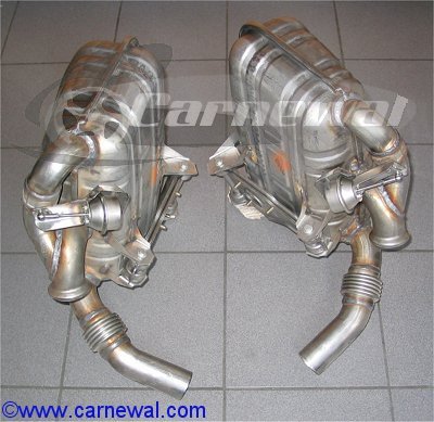

The later PSE completely re-routes the exhaust gasses through the muffler and through a different, full-size outlet pipe altogether when in loud mode. this is spliced into the part of the muffler that the tailpipe attaches to.
This later-style PSE on a 3.6 feels like it produces a little more and at least one member of the UK Porsche Club (see post from Ess_Three in this thread: http://www.porscheclubgbforum.com/tm.asp?m=99681 ) has reported over 10BHP increases on the dyno. Has anyone else had a before/after dyno run with the latest PSE?

The 2nd generation definitely looks better than the 1st gen PSE. And I hope it is an improvement. But how sure are you that the internals are extensively modified? As opposed to just adding an extra outflow pipe off the stock case. From what I've seen with my 1st gen PSE nothing would surprise me.
dj996
The exhaust gasses apparently take a different (if only shorter) route through the muffler to exit at the top rather than the centre of the can. When the valves are closed, the gas goes through an additional chamber - hence quieter - and exits through the middle outlet like standard. This was confirmed by another Porsche Club GB member who had seen a new-style can opened up but I can't find the thread just now. Will add it to this message when I find it
