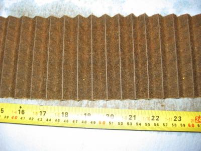

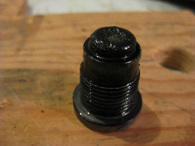

Time for a follow up for those who helped.

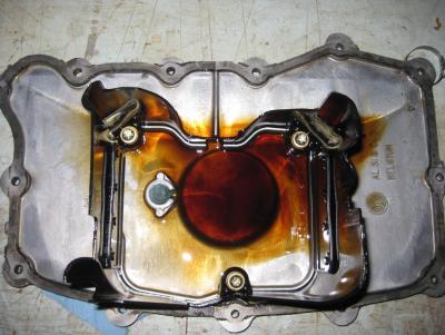

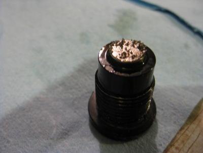

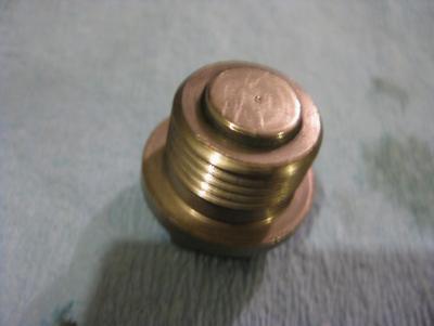

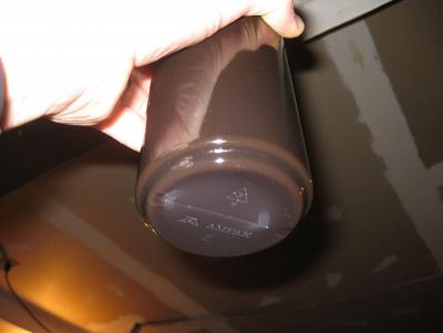

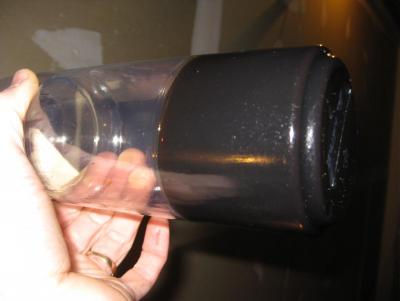

Sept 16 - As stated earlier after rebuild I started the breakin process with Joe Gibbs BR 30 (conventional oil).
Sept 20 - After 610km (385 miles) on JG BR 30 I changed oil to Castrol GTX 10W40 (conventional) with Delco EOS additive.
Pics of first 385 miles:
post-64239-0-21208200-1385423274_thumb.j
post-64239-0-90324100-1385423315_thumb.j
post-64239-0-97095600-1385423347_thumb.j
post-64239-0-97828300-1385423396_thumb.j
post-64239-0-68160300-1385423427_thumb.j

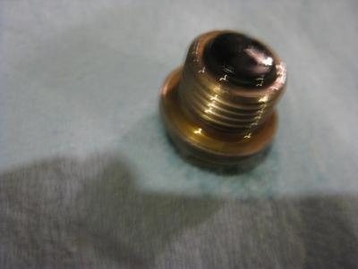

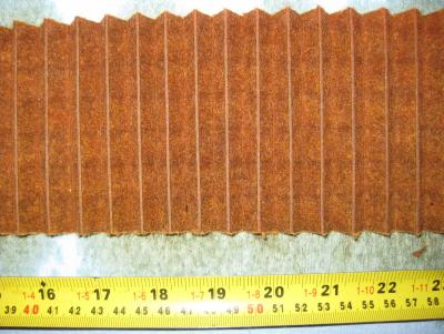

Oct 05 - with 1230km (765 miles) on Castrol GTX 10w40 and Delco EOS it was time for another oil change.
Pics of next 765 miles:
post-64239-0-63538900-1385423811_thumb.j
post-64239-0-91680600-1385423840_thumb.j
post-64239-0-46985400-1385423867_thumb.j
post-64239-0-57250200-1385423901_thumb.j

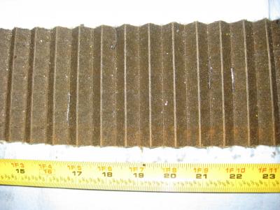

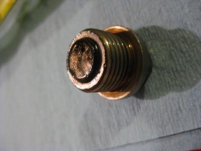

Nov 18,2013 - with 3367 km (2092 miles) on this batch of castrol GTX 10W40 and Delco EOS it was time for another oil change. This time if I used full synthetic Joe Gibbs DT 5W40. I went for a 20 min. ride and the car is garaged for the winter.
Pics of 2092 miles:
post-64239-0-92801800-1385424297_thumb.j
post-64239-0-80192100-1385424329_thumb.j
post-64239-0-65668700-1385424354_thumb.j
post-64239-0-93851800-1385424383_thumb.j
