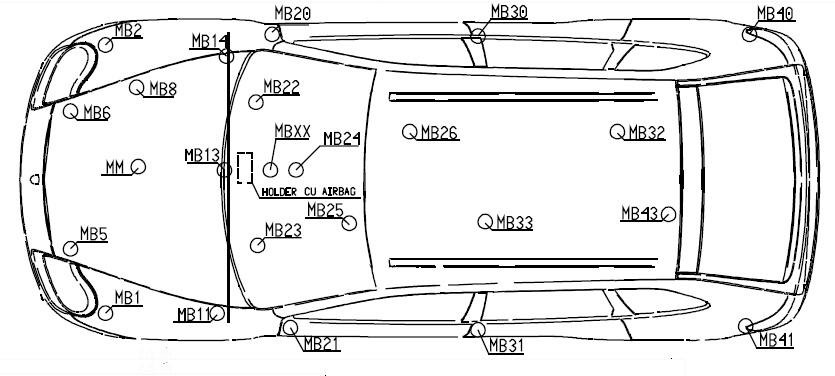

Loren how many ground points does this car have and how can i find them? Thank you.
Lots of communication faults - how old is your battery?
Have your battery both load tested and specific gravity tested.
Also check the chassis ground points to make sure they are not corroded.

All related problems are for wetness (Water from the A/C condensation) below the drivers carpet.
The electrical wires get wet and oxidate with time. Search for problems in that cables. Fix them  (re-connect) and you are ready to go.
