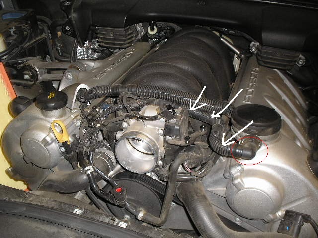

Yes, the 94810721702 is the engine crankcase to intake manifold breather hose... I already replaced it (and it was cracked) when I replaced my purge valve for fuel vapor canister 948-110-202-01
Does anyone know what part the other long accordion style pipe that sits above that breather hose you have arrowed?
It goes from one side of the engine to the other and has a "T" pipe breather in the middle? i think its 948-107-215-52-M100
Maybe should replace this as well? may help with idle?

I had same cracked hose, and T pipe cracked, also when changing air filters I noticed the hose attached to air box had come off, excited to think this could be the problem, but it wasn't. Check your hose, it's visible with a green connector on passenger side airbox.
