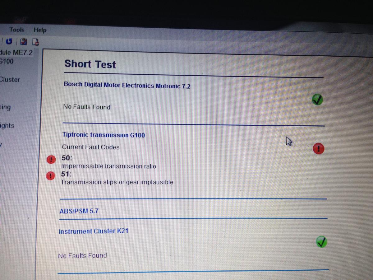

Because of the issues I'm having with my transmission, I had the local indy come by and connect his Durametrics system to my car (2002 C4S Tip RoW). Below is a picture I took of the error that was shown on his PC screen. He did clear the error codes, but when he ran the diagnostic again, the same error messages popped up. Any indication as to what this means?!

Thanks Jeff. Would this be the cause for my transmission problem (when I brake moderately, the transmission "slips" before engaging the gear; on another instance, it just remained "stuck" on 3rd gear until I re started the vehicle).

Don't really know, the code normally means the trans won't go into the "manual mode" when it is selected, and shifts in the normal "automatic mode". Haven't heard anything about slipping or getting stuck in one gear.
Yeap, in my case, the steering wheel buttons work as they should regardless if the gear selector is on "automatic" or "manual" mode.
I just hope that the ATF flush takes care of the slipping and I will not have a repeat of the stuck in a gear (where the buttons on the wheel had no effect!)

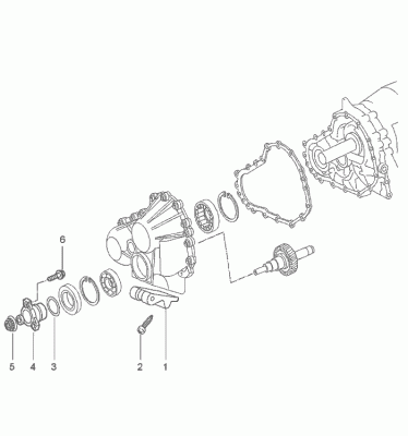

Below is what I think is the correct diagram, but unfortunately, it does not give me the part number for the large seal that is shown in the pic...
You may need to give a dealer a call for part numbers once you have isolated the leaks.
