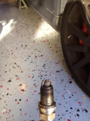

0.018" is definitely way too small. I think it's worth changing them out with the correct spec'ed ones.
The new plugs should come pregapped but it's also good to verify before installing.
Bte, are you sure about 0.06" is proper? That's greater than 1.5mm, which sounds too much to me.
Edit: googled a bit and 0.06" indeed is the proper gap

So, that gap is what it says in the workshop manual, but everywhere I look says half that. I just got new plugs and installed them. Need to finish putting everything together after dinner I hope. Not much left to do but that was a bit of a pain.
It was certainly clear that there was not enough room in those plugs to generate a decent spark. All the plugs were fouled, but the 3 & 6 were the worst. I labeled and kept them all.
We'll see what happens after I finish and probably take a few weeks for a misfire again to come up with new plugs! but hope it doesn't. Any recommendations from anyone for an additive to clean they crud out of my unburned cylinders?

Good call replacing the plugs. How many miles on the plugs? They don't look too new judging from the rounded prongs.
A lot of folks gap the Bosch FR6LOC plugs around ~ 0.028, but I would stick with spec in my own car. Certainly sounds like yours were too far out of spec regardless, so hopefully that's what is causing your problem (it often is the plugs and/or packs as the culprit when dealing with misfires). Hopefully you can trust that they put on new coil packs and this debacle with the plugs was just an innocent mistake.

Those plugs were not very old. 1 year max. They didn't look old in person either (must be the pic), just very fouled (and dirty). There was almost no gap and therefore almost no spark.
I scanned the forums for plug recommendations and saw a lot of people like the NGK Iridium plugs, so I thought I'd try that since a local parts store had the one I needed-saw online inventory (BKR6EIX)- and for a good price. I gapped them at 0.032" and that should work just fine. It says the design is for improved throttle response and anti-fouling. We'll see.
