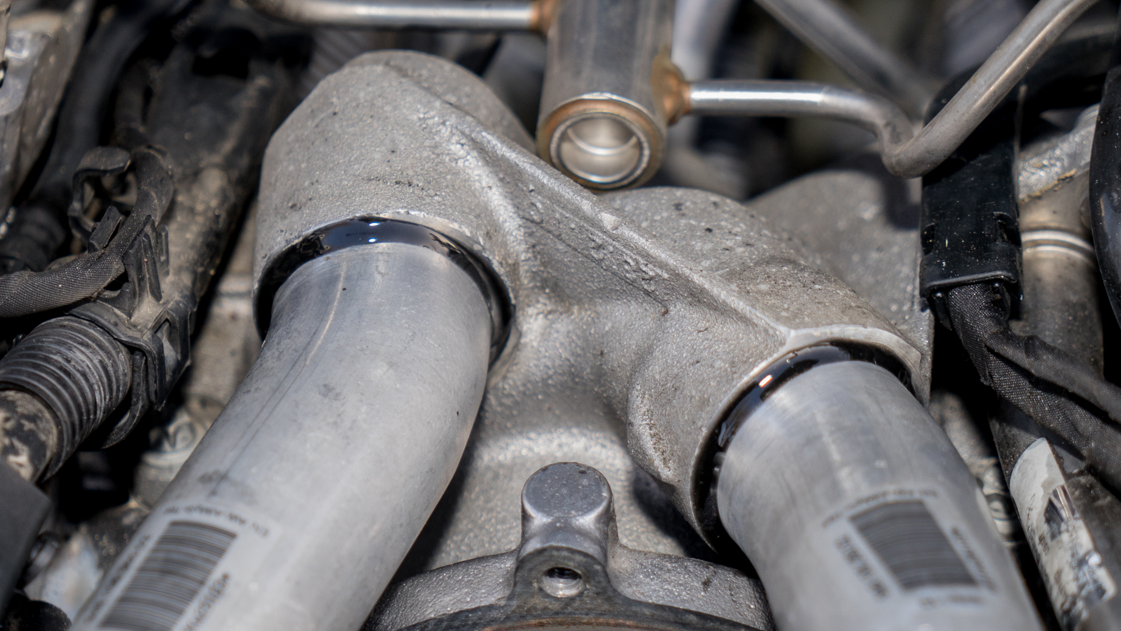

Got into my '08S and found the pipe loose on the thermostat housing.... guess I'll try cleaning and using epoxy to reinstall.... the epoxy I use for golf clubs seems to work fairly well....

Finished installing pipes in thermostat housing....
One pipe installed and epoxy spread on inside of housing for second pipe... I used the radiator hoses to hold the pipes in the proper position while the epoxy cures.
Spread epoxy on pipe before installation...
Both pipes installed
I'm quite happy with the results.....  and saved $300++
Glen
