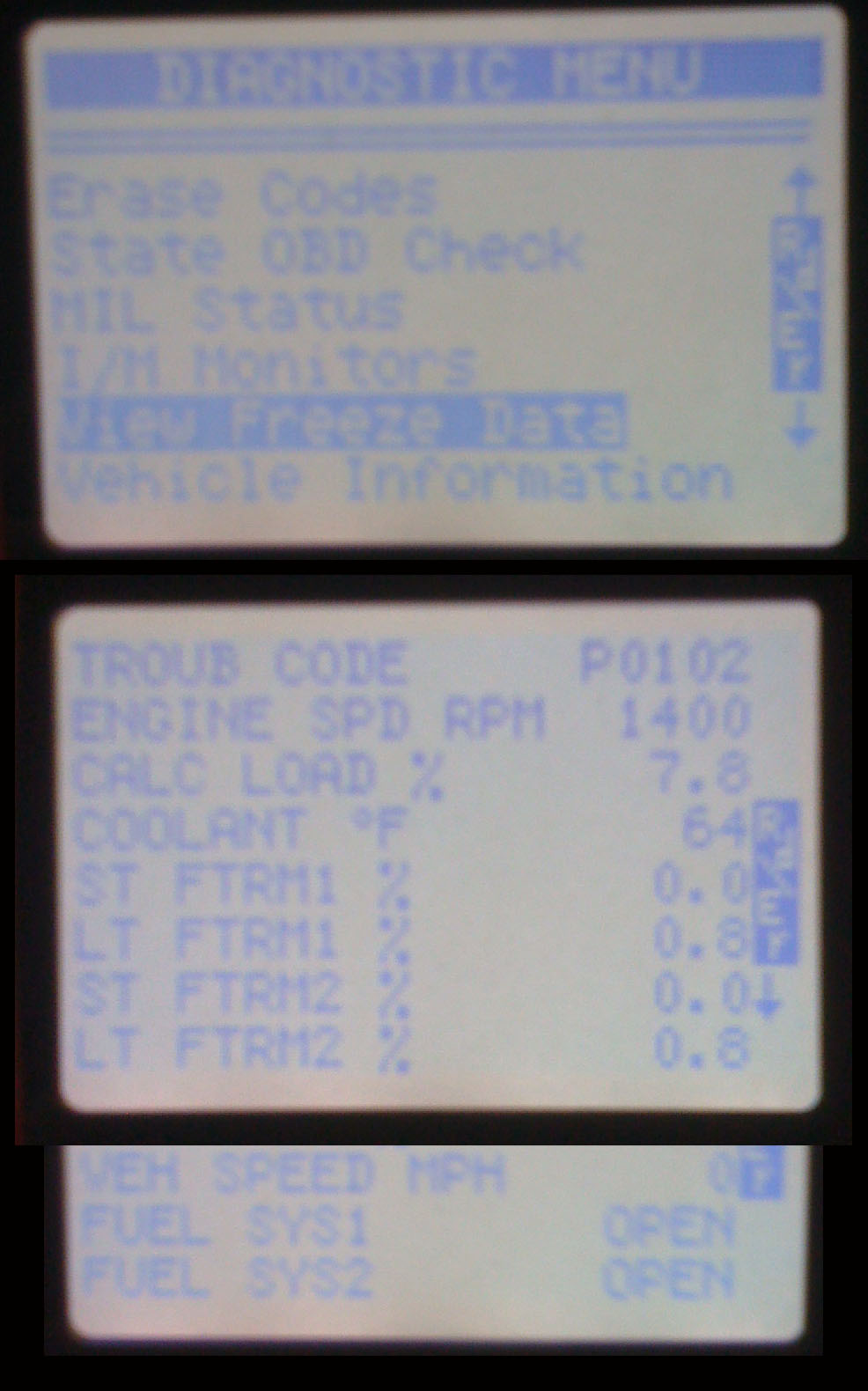

The matco scanner should be able to read MAF real-time reading. For a 3.2L, I think it should read around 4 g/s at idle (~700rpm) after fully warmed up and no electrical load on the engine (e.g., a/c). The rough idle suggests vacuum leak though. You can also check the short-term fuel trim at idle and see what the DME thinks.
This image is a series of screen shots of the test I made while the vehicle was running...No electrical load was running.
No other tests can be done on the reader that I can see.
First screen was the test selected, next series of shots are the results...I improvised the scroll down by trimming the redundant data.
post-24337-0-55341300-1389032917_thumb.j
Your engine was not fully warmed up (coolant at 64F) and the fuel system was not even in closed loop. Can you repeat the test with engine fully warmed up and at idle i.e., car not moving? Also any MAF reading?

I can't interpret the data from the "View Freeze Data", other than noticing a few irregularities, the car was warmed up, so it should have read around 180° not 64° - unless that is the ambient temp. I don't have a manual for that OBDII tester, nor can I find one online, even from the MATCO website themselves. The actual rpms at the time of this test wasn't 1400rpms, but more like 900rpms. When the CEL was triggered, the car was in first gear, somewhere in the 4000 rpm range after an initial warmup from a cold start. I recall a post where Loren notes the MAF doesn't start really working until you hit 4000+rpm.

Wow, I cannot even imagine how the data can be off by that much. I suggest you use another scanner (Durametric will be the best) since this one will only confuse you more.

I'm reading a similar Matco manual for a different more current reader since I can't find the right one for this model...The test data on the above screen shots is most likely the data "when" the CEL was triggered...hence the "Freeze Frame" notation doesn't obviously match the real time moment when I was reading the data from the tool...I'll try to run the test again after giving the car some mild amnesia after I recheck that bloody AOS hose.
Ok, that makes a lot more sense. You need it to show real-time data. If the above is accurate, that means the code was tripped at cold start, even before the system goes to close loop. Are you sure the MAF electrical connection is seated properly?

Yea, you should have a much better chance diagnosing it correctly with Durametric. The freeze frame data maybe referring to a pending P0120 code that got tripped when the engine was still cold but CEL not turned on yet. Some codes require multiple tripping before the CEL is turned on.
Yeah, I know with some readers some codes get tripped and others are pending, but this device doesn't state pending events, and, after each code event the data is purged from the reader and the system so no pending event could have occurred (looking at it as cause and effect as a best guess). The other item of note is that the FD shows both events occurring when the car is motionless...Yet both times the triggers on the dashboard occur when the car is in motion. If the FD was operating correctly, it would have recorded the speed as well.

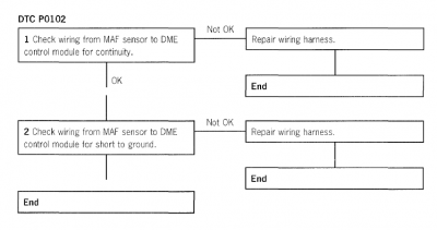

Here is the troubleshooting for a P0102 from the Porsche Service Manuals. Either the wiring is bad or the MAF is bad - period.
(click to enlarge)
