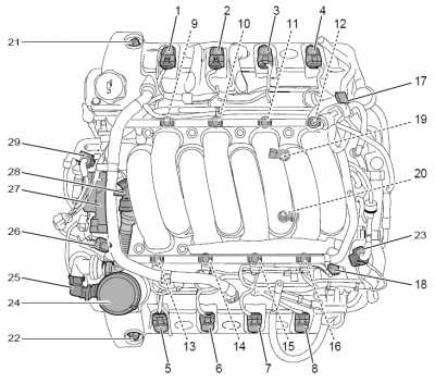

<----- FRONT
1 - Ignition module, cylinder 1, bank 1
2 - Ignition module, cylinder 2, bank 1
3 - Ignition module, cylinder 3, bank 1
4 - Ignition module, cylinder 4, bank 1
5 - Ignition module, cylinder 5, bank 2
6 - Ignition module, cylinder 6, bank 2
7 - Ignition module, cylinder 7, bank 2
8 - Ignition module, cylinder 8, bank 2
I have not seen the Durametric call the wrong cylinders, but that does not make it impossible either. That said, did you rescan it when the problem returned?

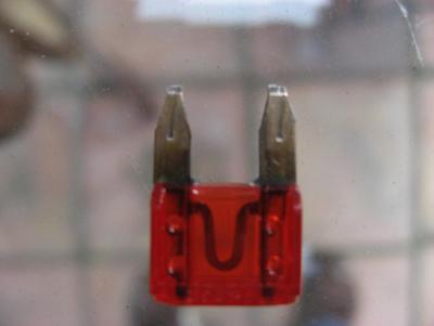

Here is a case study on a car that would not charge. The shop replaced 3 alternators and 3 batters before I was called in to diagnose the issue. After several hours of tracing and testing I found a cheap fuse did not open. The thing that threw me off, It did not fry any of the wires that led to the fuse / junction box. Here is what I found. It got so hot for extended periods it melted the internal parts of fuse / junction box. Once I replaced the fuse with a quality part the fuse would open. If I put the original fuse back it would not open and would work intermittently until it got too hot. The fix was to replace a $700.00 fuse / junction box.
I am not saying this is your issue. However you have to be a detective and prove each system for faults or no faults to eliminate throwing parts at it or jumping to conclusions.
post-29211-0-97162800-1390430777_thumb.j
