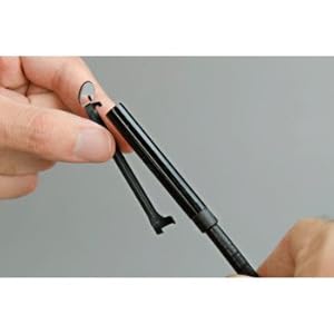

Depending on how many cars you have and how much work you do (sounds like you do a bit), one of my greatest tools is my Snapon BK6000 Video inspection camera. It will fit down the plug hole where you can inspect the cylinders, and with the mirror attachment you can look backup at the valves. Slowly crank the engine by hand and you can see all of the valve seats. You can see imperfections, scrapes & scratches in the cylinder walls. It has telescopic capability and variable lighting. I have inspected the cylinders in all of my older vehicles. See if the dealer has something similar, I would think so.

  4. He has the Snap-on scope with the mirror and can look at the valves that way.

Roy,
That is a great idea. I know it is probably commonplace for something like this, but I never thought of that. I actually have Milwaukee's version of the boroscope (see below). It can only view straight ahead, as far as I know. But I am about to look and see if there are any mirror accessories available for it.

Thank you for your input. I am picking up the car today from the dealer. After I get it, my hope is to do a compression test and also look inside the cylinder with my boroscope.
This brings me to several questions about getting the best results when looking into the cylinder....
  1. My goal is to look at three things, the top of the piston, the cylinder walls and, of course, the valves. To do this I will use it with and without the the mirror attachment. In order to see the valves, does anyone have a a diagram of where the valves are in the head? When I insert the boroscope with the mirror, especially since #4 is a little hard to get to at the firewall, I would like to see a diagram as to where the valves are. In other words, at 12 o'clock, 3 o'clock, 6 o'clock or 9 o'clock. That way I will know the right clocking of the mirror to see what I need to see.
  2. In order to see the top of piston, cylinder walls and valves, it makes sense to have the piston at bottom dead center (BDC). Is there a way to accomplish this other than trial and error?
Thanks in advance for contributions.
