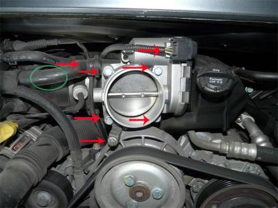

I cleaned the throttle body before I reinstalled the motor.
I have NOT cleaned the idle stabilizer...that will be my next task after your suggestion...thanks for making it !
