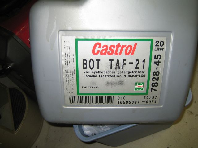

Hey Loren, btw I picked up the factory castrol from the dealer and used it for the fill. As I used the off the shelf mobile 1 previously I can say there is a noticeable difference in the shift quality especially when hot and somewhat when cold. I would go with the factory fill again over the off the shelf mobile 1. I also picked up enough to do 2 changes though :) The dealer threw in a few liters for free as it was the end of the container :)
Factory Castrol? The 996 transmission (G96/00) is factory filled with 75w90 Shell Transaxle Oil.
Edited by PTEC
I am pretty sure it was castrol. I got it straight from the dealer after I asked for gt3 tranny fluid because I was concerned about my lsd. It is better than anything I have used in it fwiw.
it is a 75/90 and I am already familiar with what you are professing as it is in Loren's DIY. I am just stating what I picked up and used, and it seems to me to be far superior that what came in the car and better than the off the shelf mobile 1 of the same weight.
Is there a way to check? I got it from autogallery and that is what they use and recommend for the gt3. I really do like the results of the use btw, but now you have me scared about possible damage or lack of protection?
Maybe it is not recommended because of the need to change it more frequently? If that is simply the case then I will leave it in because it is that much nicer. Assuming it's ok what is the change interval? Thanks
Hey Loren can you please give me some feedback or suggestion on the differences of the fluid? I don't want to damage anything and will want to remedy the sitiauation asap. Thanks Sean
Dunno it is the stuff in the picture but I can say that it shifts better than it ever has both cold and hot.

So Loren I checked my invoice to try and figure out whether or not the fluid would cause any damage to my tranny. The part number listed is: 000-043-204-71
I noted that this part number is obviously different than that listed as approved. The dealer tried to tell me that that part number was approved for all P cars from 98-07???? It appears that my second gear and 4th are a pita to shift now. I don't know if the fluid is too slippery and is not letting the syncros engage or what but when I shift it into second say, it tickles the teeth and then goes in. I am wondering whether any damage occured and then it would be something to take up with them.
Please let me know what the part number is for. I checked my pet5 and it didn't come up.
Thanks sean
EDIT: does anyone have a full list of approved gear oils/tranny fluids?
Yes, there is a list of "Porsche approved" transmission oils as well as motor oils in the (Contributor's Only) TSB section.
000.043.204.71 is transmission oil. It is listed for the Boxster 97 to 06. It is should work fine a Carrera too. I would guess they have just changed vendors so a different part number.
so does that mean 1. that the container that I took a pic of is fine to use and is the same as that part number, or 2. that the fluid is maybe something different than what the container says? Thanks.
LOL I have no idea what was in that container. Porsche only approves the use of the synthetic gearoil specified.
If you are really concerned then change to a Shell synthetic or Redline equal.
