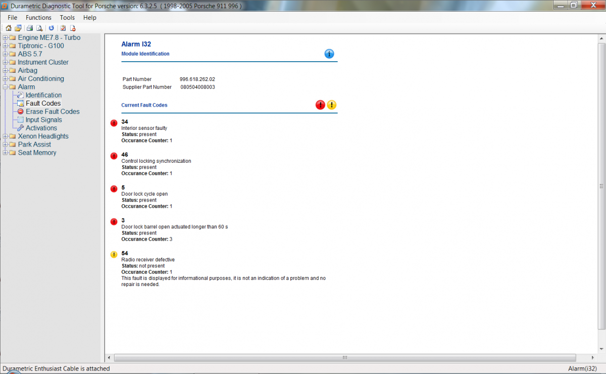

Car is 2002 996TT
Today I have the common fault: can't lock the car with the remote and it beeps twice. I can lock it with the 3 key turn thing.
I have read the codes with Durametric (see attached screen capture).
Am I right in assuming I have a bad microswitch (stuck open) in one of the door lock mechanisms? How can I tell which one, left or right? Has any one ever managed to repair/unstick the micro switch or is there no other solution other than replacing the complete door lock, i.e., 8N1837015C for the left door or 3B1837016P for the right door?

post-18763-0-86210700-1392486153_thumb.p
I would also note the code 54, which says the radio is not present, a common problem on cars with retrofitted audio system is the missing radio chassis ground.
Yes I replaced the radio but it's been like that for years, no problem ever came off that.
