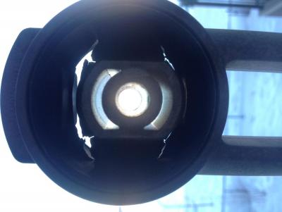

Me thinkst this Bushing was kaput
We used to fill the boxster engine mounts with a liquid plastic to fill the void. Seems to work better than the original rubber porsche used.

I really like this idea.. any suggestion on what to use? Would RTV work?
Try google: Devon Flexane 94 for prices.
Here is the link to the manufacturer: http://www.devcon.com/products/products.cfm?family=Flexane®%2094%20Liquid
This should be better than the original.

Thanks. Pricey little devil isn't it.. It's the sort of thing people should do a group buy on one package, since it looks like 1LB (the amount it comes in) would be enough to do a LOT of the mount bushings.
