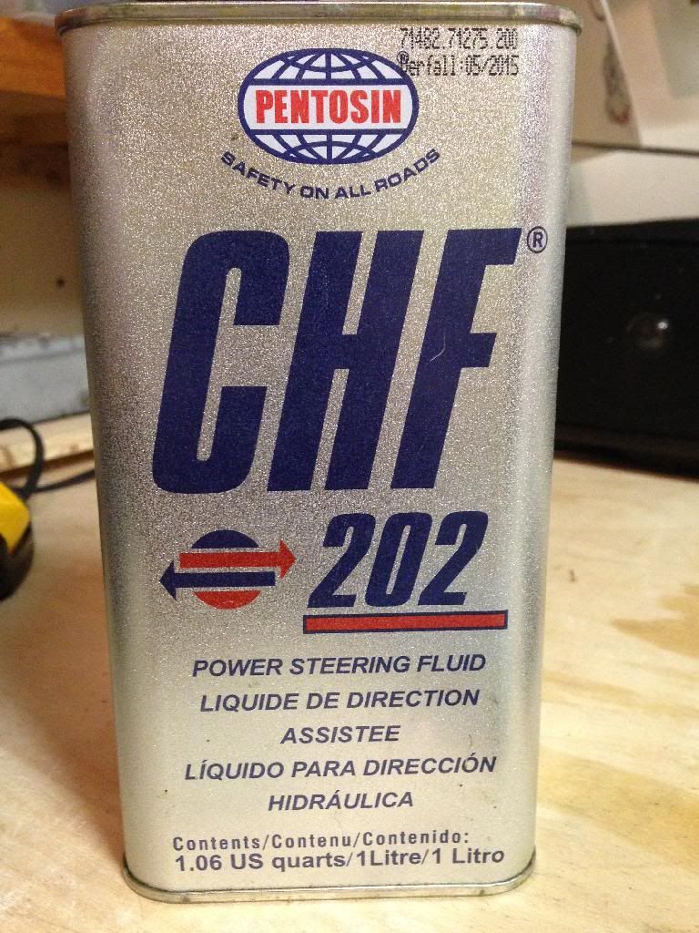

Thank you JFP, will do the easier route in spring if it ever comes to WI. Do I need a special Pcar fluid?
The correct fluid for the car is Pentosin CH11 S, available on line and from many retail auto parts outlets as well.

Pentosin. My local Car-Quest auto parts house carries the CHF 111S for about $25.00 a can. And I'm going to add the P/S inline filter as well...
Yes, the return line at the rack.
I would not be running anything but the correct fluid in the car, even to clean it out. There are a myriad of flexible seals in this system, and the use of an incompatible fluid could lead to swelling or other problems. The system does not hold that much fluid, so it simply is not worth the risk......
