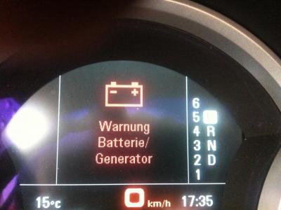

Anyway, i will just explain it in a short way.
The Turbo which i have now for some weeks was driving almost perfect since i got the car some weeks ago.
I just replaced the battery because the car didnt start always on the first attempt.
Today i drove to gas station. From one minute to next idle went up to arround 800to 1000 and on the display the battery sign appears.
Followed by the information: vehikel shutting down electronic devices.
After i couldnt start. I waited a minute and car runs normal. After some minutes again idle up to 1000 and
The battery symbol on the display.
Does it mean my alternator said good by or is it something more serious?
Thank you
You need to have the alternator checked for out put, it may be as simple as a bad voltage regulator.

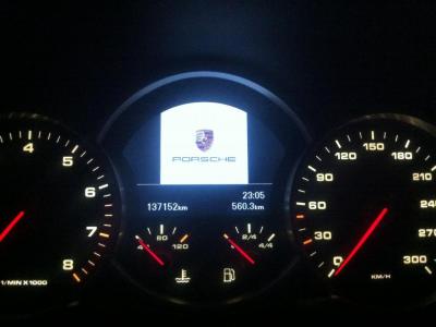

Here i am again. The car stay for some days and now nothing is working. Dead. I had to use my other cayenne to start the turbo via cable. Car started without problem. After i used the multimeter i bought to messure the voltage. Looks like the alternator us ok. The multimeter is showing same numbers on the turbo like in the s. So as i understand it cant be the alternator.
Tomorrow u will change the batterie. I will see what will happen after.
What i am wondering about it the following subject.
The car is locked. Lights switch off. But the dash is fully iluminated.
What the ...... Is this?
post-77547-0-96478700-1395529251_thumb.j
Why would you replace the battery if you have found the reason for the power drain already, the dash! It seems to my better to tackle this problem first.

The battery is totaly down and i thought might be better to replace. I have one at home.
The display problem occured just AFTER i did thid jump start. So i believe thats not the original problem.
Thank you
I would like to try first to take out the fuse for the dash allumination if there is one. According my om it should be number 40. somebody can confirm this
I changed the batterie for a new one. Starting normal. But after some minutes of running car starts to rev a little bit higher at 1000 and some time later batterie sign in display appears. I connect the multimeter to + and - in the engine bay. This is showing 13.8 / 14.00
Second round . Now the multimeter shows ZERO.
So for me it looks like the alternator is not working proper.
Now my question. How far is it possible to drive with a fully loaded battery and a faulty alternator?
