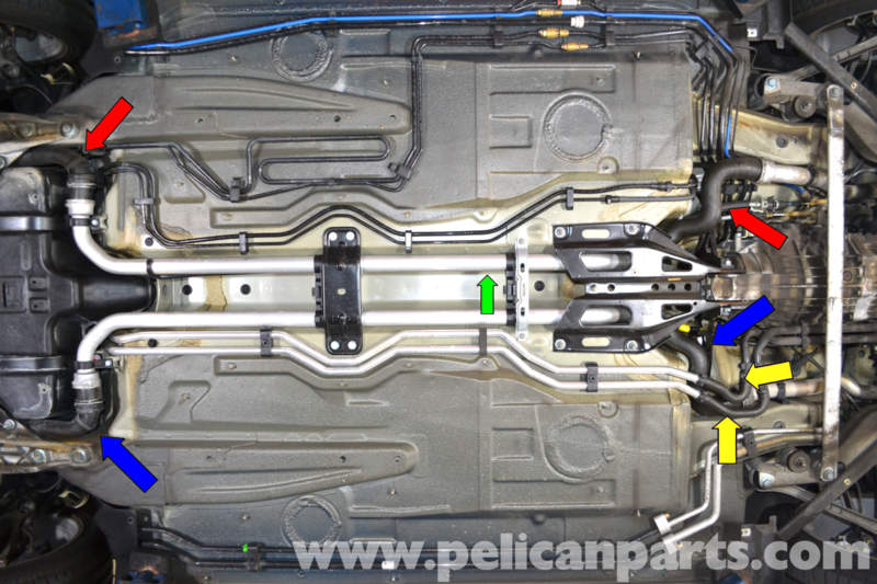

one thing I noticed when it was on my buddies hoist is the metal lines travelling underneath the passenger side had some kinks in it. looks like a diy jacking gone wrong to me. anyways, what are those lines? coolant lines? heater core lines? I would like to replace the section that is kinked but having a hard time figuring out what they are for.

Those lines also include brake and clutch lines - best investigate the damage further.
are you sure? the brake lines and clutch lines look to be on the drivers side, those look great. these are thicker lines, maybe 1/2 " lines. never seen clutch and brake lines that thick. I am suspecting its these...
sure looks liken it anyways.
http://www.jimellisporscheparts.com/products/Return-line-hot-air-duct-heater-pipeline-PIPE-LINE/3811522/99657268305.html
6 & 8 or 6 & 10? 8 looks to be the washer between the flanges.
thanks again.
ill contact my porsche dealer and give them the vin....at least I now know what lines they are.
Yes, 6 and 10. Sorry for the typo. Good call giving them the vin to verify fit.
