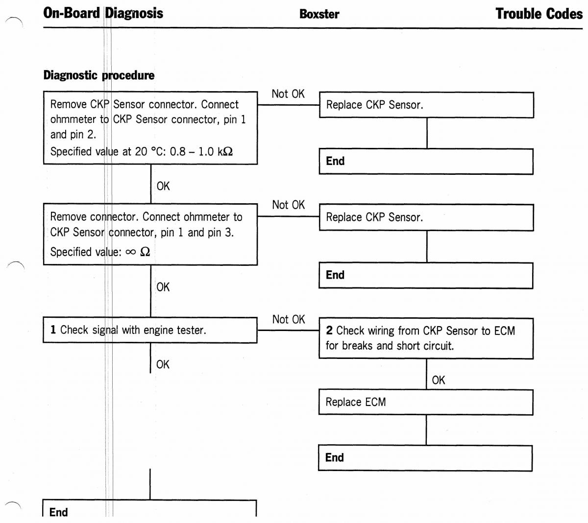

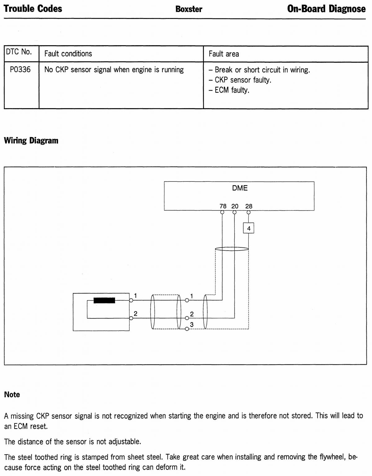

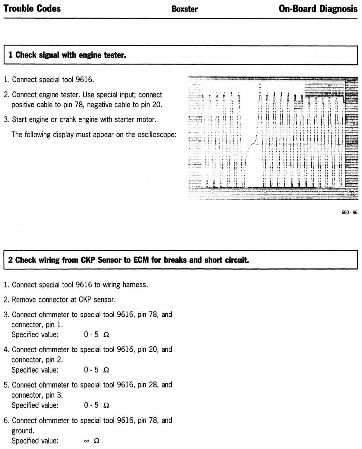

Does the camshaft sensor have the same symptoms? How can I tell if its the camshaft sensor or the crankshaft sensor? None of the local parts stores have crankshaft sensors, a camshaft sensor is available, which leads me to believe the camshaft sensor is a more common repair?
Actually, it often the other way around. There are more camshaft sensors than crank position sensors in these cars, which is why the aftermarket stock them. Besides which, a failing cam position sensor would throw codes, while a failing crank position sensor rarely does, it just shuts off the fuel pump because it thinks the engine is not turning over. Test the crank sensor.
John, that file applies for Boxsters as well (the file is for Cayenne)?
They are very similar in terms of how to test the sensor, but some of the other info is Cayenne specific. Just about all CPS sensors are simple Hall Effect units, so they work the same.
Cool. Downloaded for future reference. Thanks! :)
