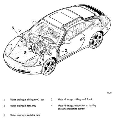

anyone have any tips on cleaning out the ventilation ducts? i guess that bacteria is growing after the AC has been on and condensation accumulates but where is it accumulating? are there drain holes that need to be unplugged? lysol in the ducts?

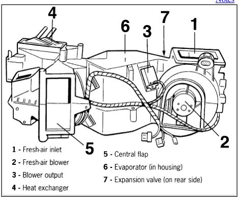

so here's the evaporator assembly but where is it located? if i can spray some disinfectant into the inlet while it's blowing then that may do the trick. i guess it's downstream from the pollen filter.
