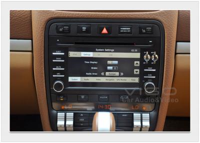

Just got the newest Android unit from SEICANE.com, this seems to be the until that lots of other vendors are fronting.
Will install it next weekend.  Have to junk the Bose amplifier. Speakers will end up amplified by the internal amp in the unit.
I have had the unit in the car. Everything looks like it works. Nav looks top notch.
Now we remove liners in the back and disconnect connector from BOSE amp and plug it into the can-bus 15 foot extension and then snake that back to the dash and do some very minor adjustments and that connect to the other plug and play stuff that came with the new head unit.
Looks doable..
If I hadn't had the BOSE fiber optic system would have been a 25 minute job.  Head unit looks good but only time will tell.

Just finished.  It worked.
No longer have 10 speakers punching out so so Bose sound. Instead have 4 speakers punching out so so internal amplifier sound.
That doesn't really matter since the PCM was pooched and was resetting itself every five minutes and that is if you could get past the fact that the screen had died and was acting totally wonky.
What I do have now is full bluetooth. Full android. Touch screen. Top notch navigation with current maps and traffic. "Seicane S127014 Quad-core Android 4.4.4 In Dash Car DVD GPS System for 2003-2010 Porsche Cayenne with AM FM Radio Bluetooth Music Mirror Link OBD2 3G WiFi HD 1024*600 Multi-touch Capacitive Screen"
details at
http://www.seicane.com/seicane-s127014-quad-core-android-4-4-4-in-dash-car-dvd-gps-system-for-2003-2010-porsche-cayenne-with-am-fm-radio-bluetooth-music-mirror-link-obd2-3g-wifi-hd-1024-600-multi-touch-capacitive-screen
For $610 US plus about another $100 in shipping and duty and about 3 hours of my time, I'm quite happy.
