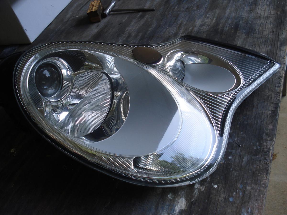

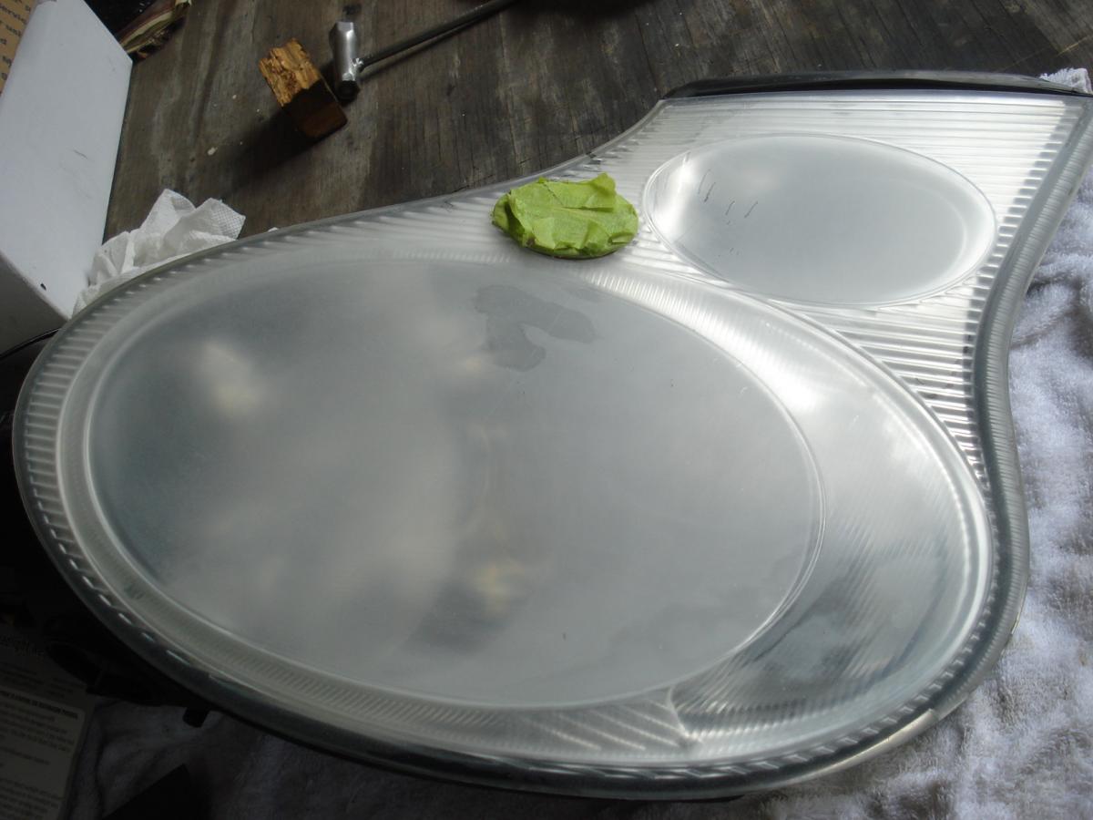

post-25987-0-69120800-1441673843_thumb.jpost-25987-0-79217700-1441673859_thumb.jGreat advice kgoertz - I used a small AC compressor using one of the inflatable toy adapters (See photos) - hit the compressor for about 1 second and the washer pops up. Leaving the compressor connected, but not on, keeps enough back pressure to keep the washer popped up as I removed it. The best way is to lightly compress the tabs on the main shaft, then the chrome cap just pops off.
btw I completed one light - for me I needed one 3M kit per headlight, so the passenger side is next weekends project....
