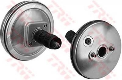

Checked the TSB, thank you so much!! Now, I found the brake booster on many internet shop (TRW PSA521)...and ALL these sites state that there is compatibility between the part and my car. So, as the part include also the seal (see photo) have I to buy the new seal set too (000 043 204 66) or not?post-102989-0-68455400-1439133842_thumb. Edited by Stefano Buganza

As Loren has rightly pointed out, the brake booster is an issue with your model year. However, a defective booster will normally result in it requiring a lot more strength to push down on the brake pedal and, once depressed, the pedal not returning to its original position (remaining depressed).
Before spending on a new booster, I still think you need to establish whether you have a leak of brake fluid. Mark the level on the fluid reservoir with a pencil, repeatedly apply the brakes and then check the level again.
To check whether the booster is working properly, with the engine switched off pump the brake pedal a few times, then, while holding down the pedal, start the engine. The pedal should ease downwards a little as the engine starts.
