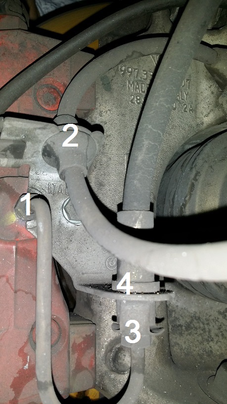

Ok so do I need to remove all the joints numbered 1 through 4 to get the flex lines off? I assume I do If I am removing the caliper and flex lines, there is a little hard line from the flex line to the caliper, this comes off as well I assume?

There are spring clips at  #2 & 4 that need to be removed, and then you will need a proper fitting wrench to remove the lines:

Thanks guys, I haven't seen the spring clips yet, I assume they just come off with pliers?

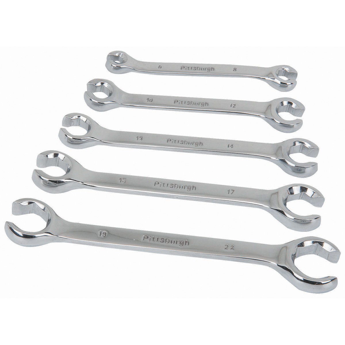

I have bought some flare wrenches for the hoses.

Needle nose pliers are the tool of choice for the clips.

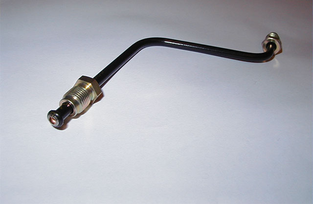

The threaded connection to the hard lines will actually slide back to expose the flared end of the hard line, so the hose needs to fit the line flare not the threaded fitting:

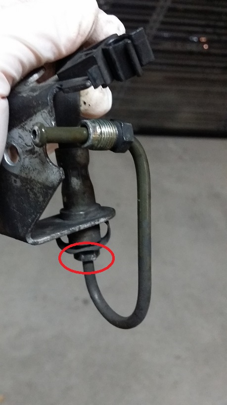

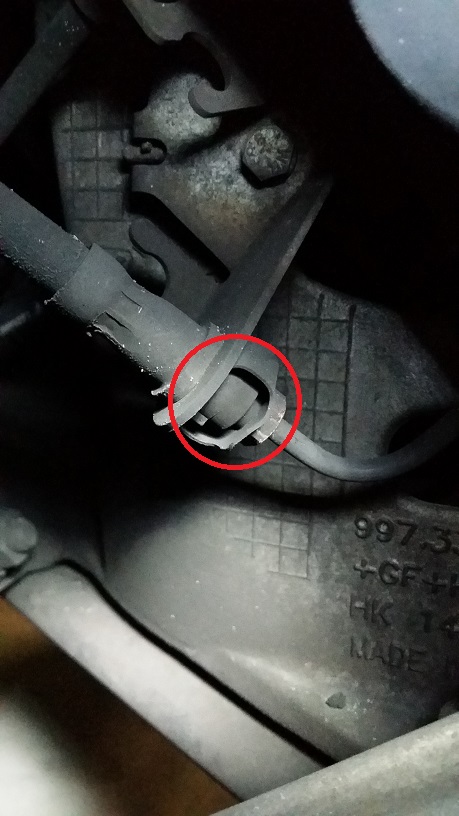

Does this part circled come off first or can I just start undoing the nut on the hard brake line as is?
The hard line flare nut can be undone without removing the clip, but as the clip will need to come off to remove the flex line anyway, I would just take it off.

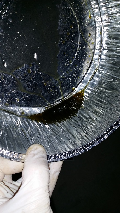

I also only managed to spill this amount out of both rear brake lines
Actually it wasn't a total success, in removing the rear flex lines I bent the bracket that attaches to the back of the rear calipers which holds the hard line. The nut circled was too hard to get off so I'll have to replace this part in order to replace the flex line.
