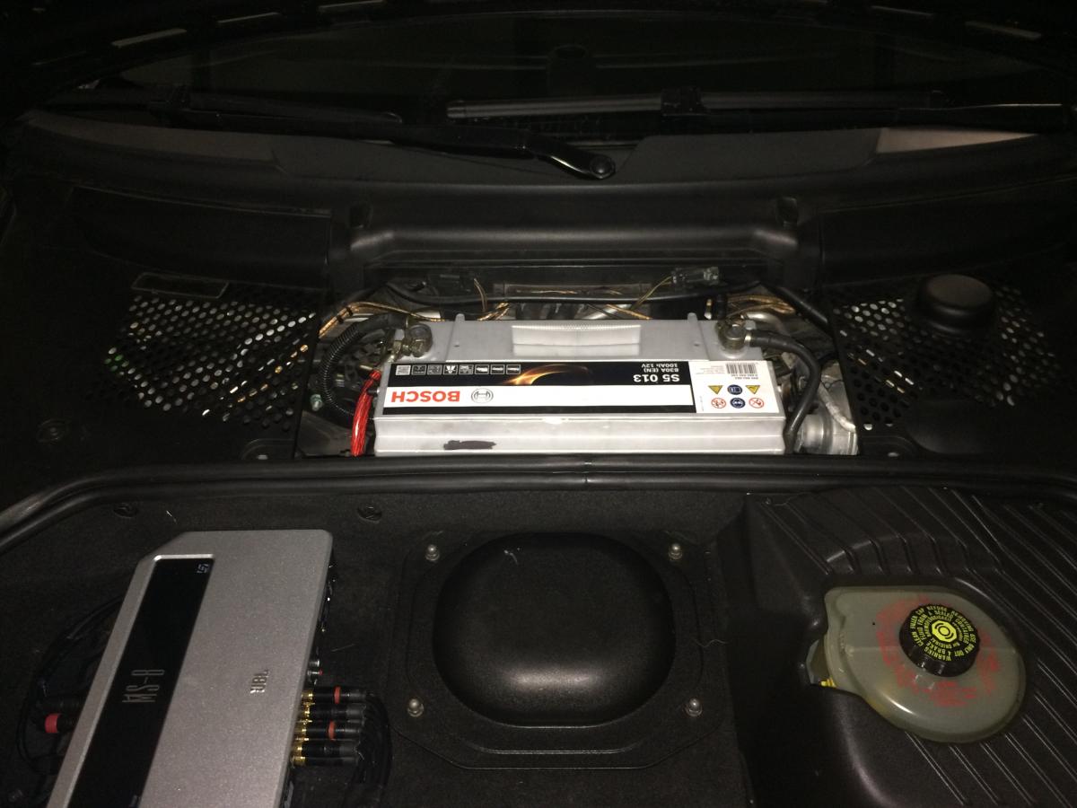

Funny you mention that, it just died this morning with no pre-warning. 2-years old Porsche Moll. Ordered a Bosch S5 013, 100Ah 830A for half the OEM 80Ah 800A that's in place. My car originally had the M197 option, so has a huge battery tray ready for larger batteries, hence my ordering the biggest Bosch that fits.
Share this post
Huge battery installed, fits just fine. Hope it lasts for more than a couple of years... As to the gremlins, I'll see in the upcoming days whether they'll go away. The new ignition switch has not arrived yet but I'll put it in anyway AFTER I determine whether the gremlins were battery related.

That wouldn't be a monster amp in the frunk would it? One that could suck the battery inside out in a 1/2 hour? If so that could contribute to the short battery life.
Share this post
Nope, just a JBL Class D digital signal processor. I do have two Alpine Class D amps connected to the outputs of the JBL, however I installed all these in 2008 when I bought the car and the Porsche/Moll battery that came installed only died in 2012 or 2013. I dont' know how old it was before that but 4/5 years is very good already.
The Class D system I have in place is very good and power efficient. I remember doing the load calculations in 2008 and reaching the conclusion that I had ample reserve to spare, considering the battery and alternator specs.
