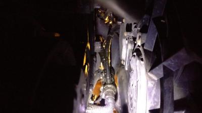

I did however notice something when I was changing the oil today...pics attached.
The first two show the two PCV hoses covered with oil from underneath.  Notice those are essentially the only things with oil on them.
The last two attempt to show what looks to be the source of the oil with the last pic being my finger trying to point it out.  If you can tell, it looks like the section above the clip that holds the small hose is dry while below it is full of residue.
Am I correct that if there is a hole in the PCV hose that oil will leak out?

So, when I detached the valve, this happened...
I think that'll cause a slight vacuum leak  :thumbup:
I had to get to a job interview in 2 hours, so I needed a pronto Macguyver fix.  Luckily, Super33+ tape seemed to do the job:
Cleared the codes (had popped for both banks this time...P2187 and P2189) and took a short drive with no CEL recurrence.  LiveData shows STFT = 25 on both banks at idle after the tape job.  Will report back after more drive time.
