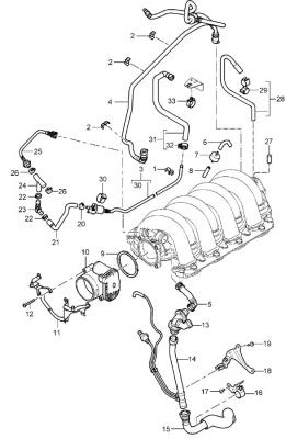

That is #14 in the diagram. If #15 is also bad, how much of a PITA is that to replace? I assume you remove the wheel well cover?

It varies by year and model, but going in through the wheel well us usually the easiest.  No special tools are required and the hose ends have pinch to release fittings on them, just be sure to lightly oil the seal rings inside the new hose ends before installing.
