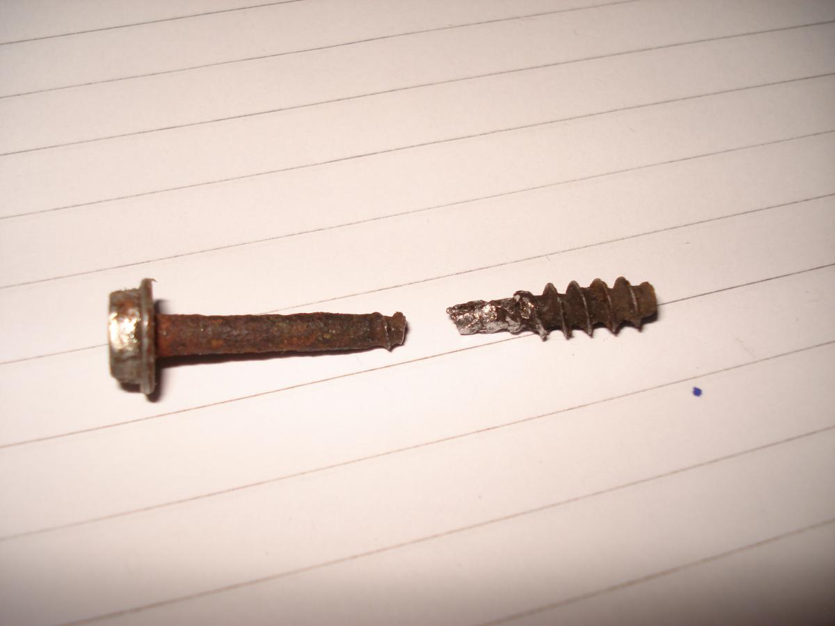

Your valve is leaking (likely the diaphragm has cracks). The best bet is to replace the whole tank. Don't bother trying to replace that valve and the screws, which are like one-time use.
I've have replaced the valve without an issue.  I also replaced the screws as they are typically for one time use as Ahsai suggests.  Don't over tighten the new screws as they can strip easy.  I figured if that didn't work I could always replace the tank. A new tank comes with a new valve already installed.
