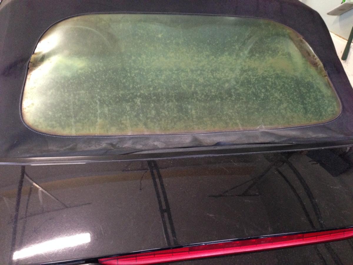

I'll try posting here first.
My issue is that the soft top will suddenly not open. The electrics is fine, the motor spins, but the passenger side drive cable twitches when I try lowering it but the roof won't move. When I unplug this cable the other side is moving the roof cover without issues.
I even managed to get it moving by rising driver side slightly, then the passenger side would move and after I alligned them back, the roof would open. Only once, though, it would not open again after closing.
Is this a symptom of a transmission issue?
