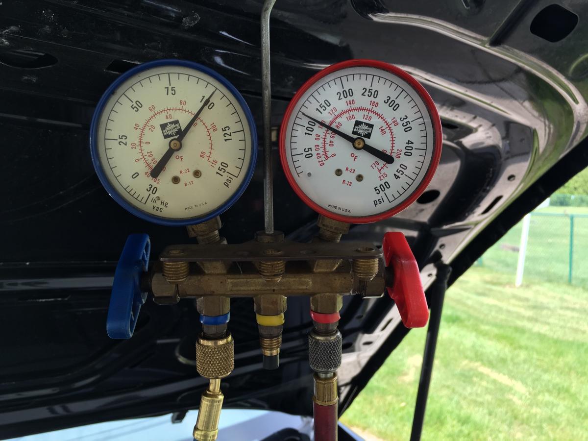

My air conditioning has intermittently been working since I purchased the vehicle but seemed to be getting worse and worse about blowing cold. It is a dual zone automatic climate control system. Sometimes I can get it to blow cold but constantly fooling with the settings, modes, and fan speeds but lately it is very hard. I am 99% sure that the A/C compressor is cycling because there is a change in pitch in the engine when I turn the temperature low, but still no cold air coming out of vents. I put 1.5 cans of freon in the system with a simple can & hose, but it will not accept any more, so I assume its full. Any common issues or things to try and fix this without an expensive trip to the dealer? I appreciate your help! Please advise.

First of all, simply adding gas to a system without knowing what pressures it is already at (particularly the high side in relation to the ambient air temps)is asking for a disaster.  There are ways to test these systems to determine if the current gas charge is correct or not.  You may have already over charged the system which could cause it to go into very expensive and potentially dangerous component failure.
Separately, your multi zone control system may be stuck or malfunctioning, which could be the basis of your original issue.  If you do not understand these systems, or lack the diagnostic equipment to work on them, take the car to a pro who does, before you make a bad situation worse.
That is what I am requesting, how to test them and fix this issue myself. I know how to take it to a dealer and pay the bill, but am more interested in learning and fixing it myself.
I have access to A/C pressure gauges I can hook up and just purchased a Durametric scan tool. Any help on diagnosing my issue is greatly appreciated. Please advise.

Are the gauges you have 134A or are they set up for R12?
You will need access to the factory service manual for the system in order to look up the correct pressure/ambient temperature relationships and reset the pressure correctly.  If the system is already overfilled, you will need access to a certified gas recovery system to remove the excess gas to get down to the correct levels.
The Durametric system is capable of reading and diagnosing AC systems, but the level varies by model and year somewhat.
The AC gas volume is 700grams for non 4 zone and 1050grams for 4 zone AC systems on all cayenne 955.
The gauge won't tell you how much gas you have filled and by looking at you low pressure gas gauge it's go too much in it I think.
Best to drain the whole gas out and only add the exact amount when recharging.
An AC machine would such out the old gas check for vacuum pressure hence any leaks and then re-gas the correct set amount you tell it.
