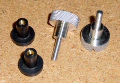

Hi Loren,
Thank you for the posting information. Here's a sneak preview picture of the Cover Hold-Down Thumb Screw Set. This kit allows easy access to the cowl/pollen filter area for cleaning and maintenance. For convenience, the screws are slotted and can be tightened with a 25 cent piece (quarter). Of course, a screwdriver can be used too. The screws in the picture are unplated. However, when finished, they will be black anodized. This kit is a direct replacement for the two factory Torx #20 hold-down screws (999 073 143 09). The kit also includes two new nuts (999 500 092 00). Your feedback is always appreciated

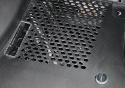

Hi Craig,
Thanks for the email. Yes sir! This is going to be a production piece. The kit will include: two knurled thumb screws, two replacement nuts, and a Torx #20 wrench. Here's a picture of the screw installed.

Flagman, my problem has been with the female end spinning while turning the male end. So it can be very difficult to loosen this fastener (in stock configuration). Does your product solve that problem?
Does anyone have any suggestions on how to solve or alleviate that problem?

Hi b-man,
Thank you for the response and feedback. That's definitely a problem. I've experienced it on my 03 car numerous times. With knurled screw set, you can use your thumb and forefinger to pull up and tighten at the same time. This puts enough pressure on the rubber nut to keep it in place. With the factory Torx screws, you can't do this. So the rubber nut spins in place. I hope this answers your question.
