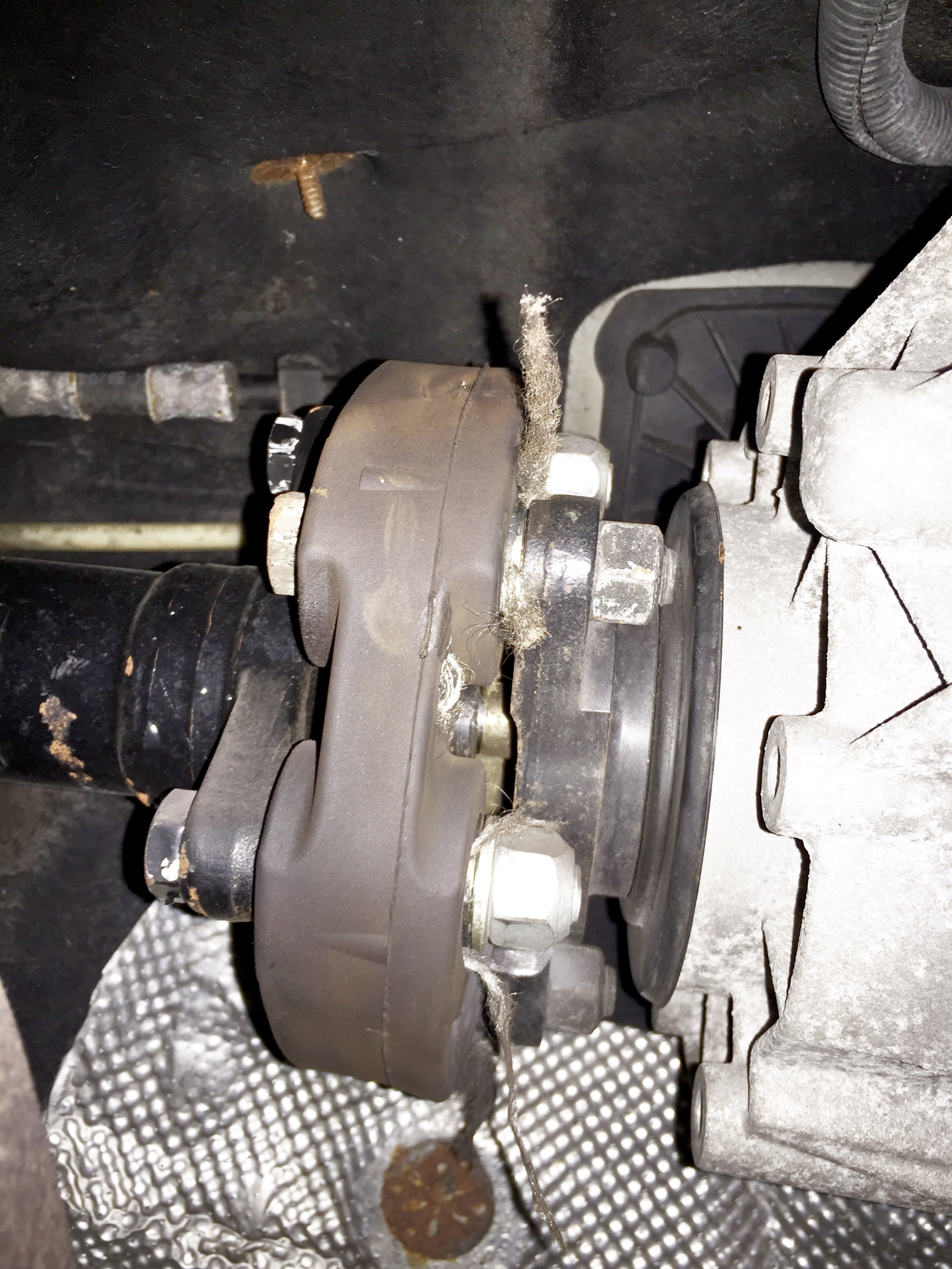

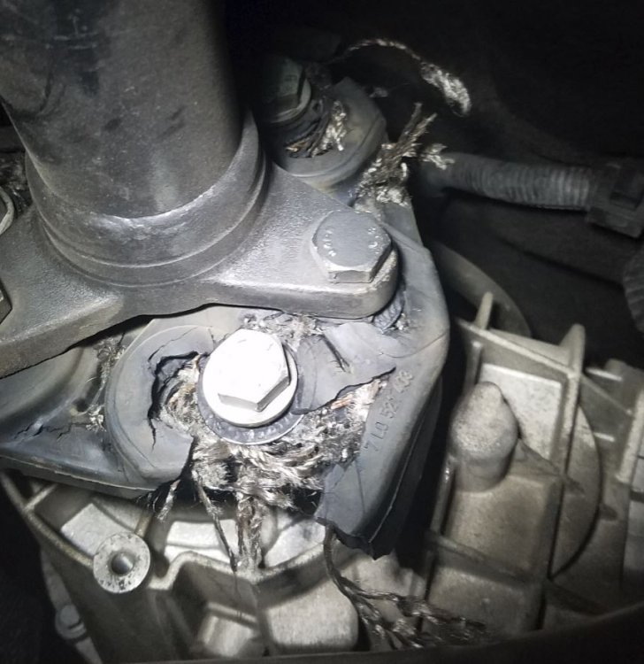

Driving to work the other day, bang bang bang. Hear the all too familiar banging noise.
Barely got home that evening. Took some pics.
Has anyone had their flex disc torn? I have never heard of it. It was OEM (at least was claimed to be).
Questions:
1. With the flex disc gone, does this mean the shaft is in need of replacement too? I was hearing that banging sound from under my car seat area when driving (even slow speed, when accelerating).
2. What other hardware do I need (aside of drive shaft and flex disc) when doing the replacement? Do not recall anymore.

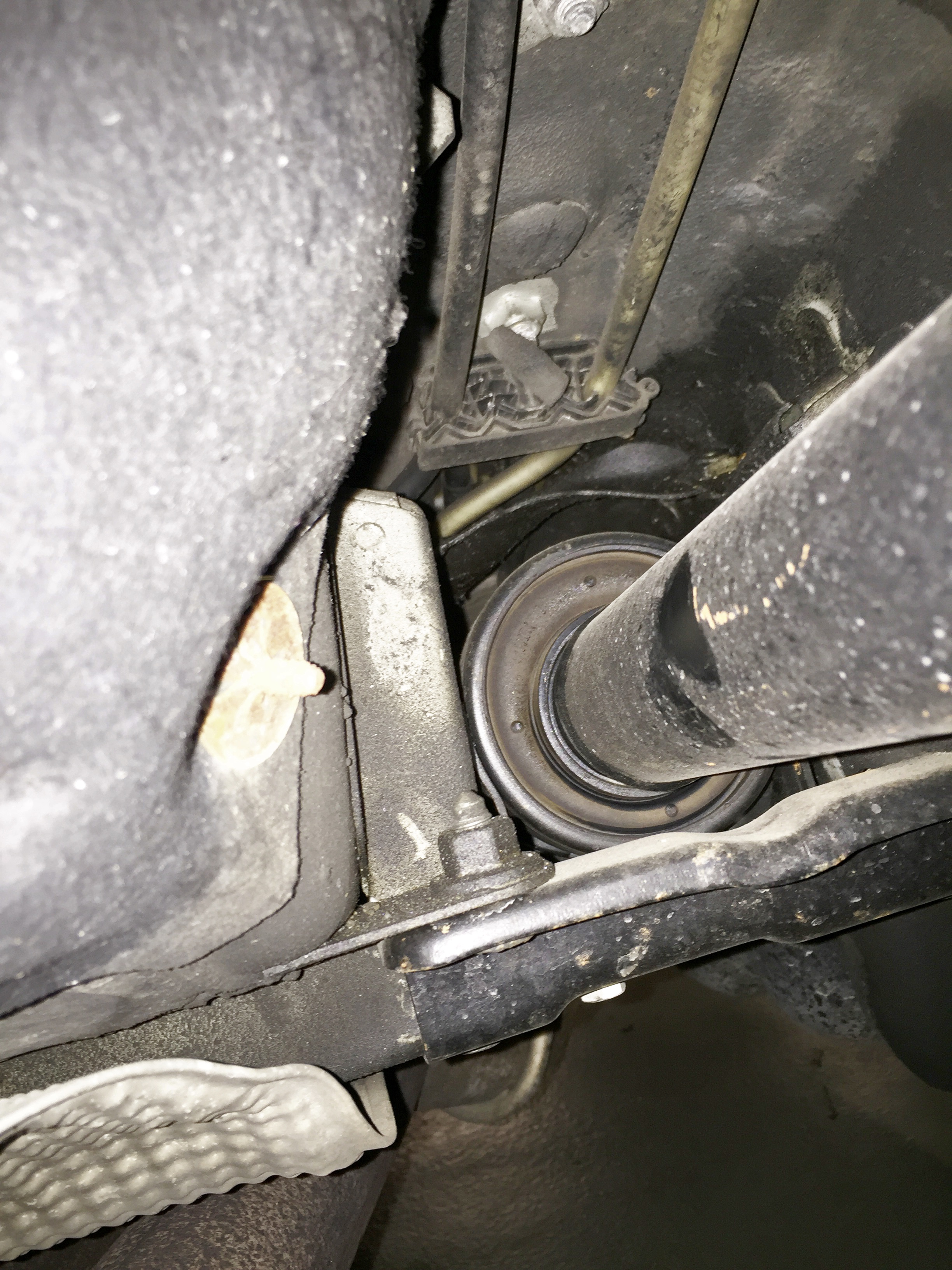

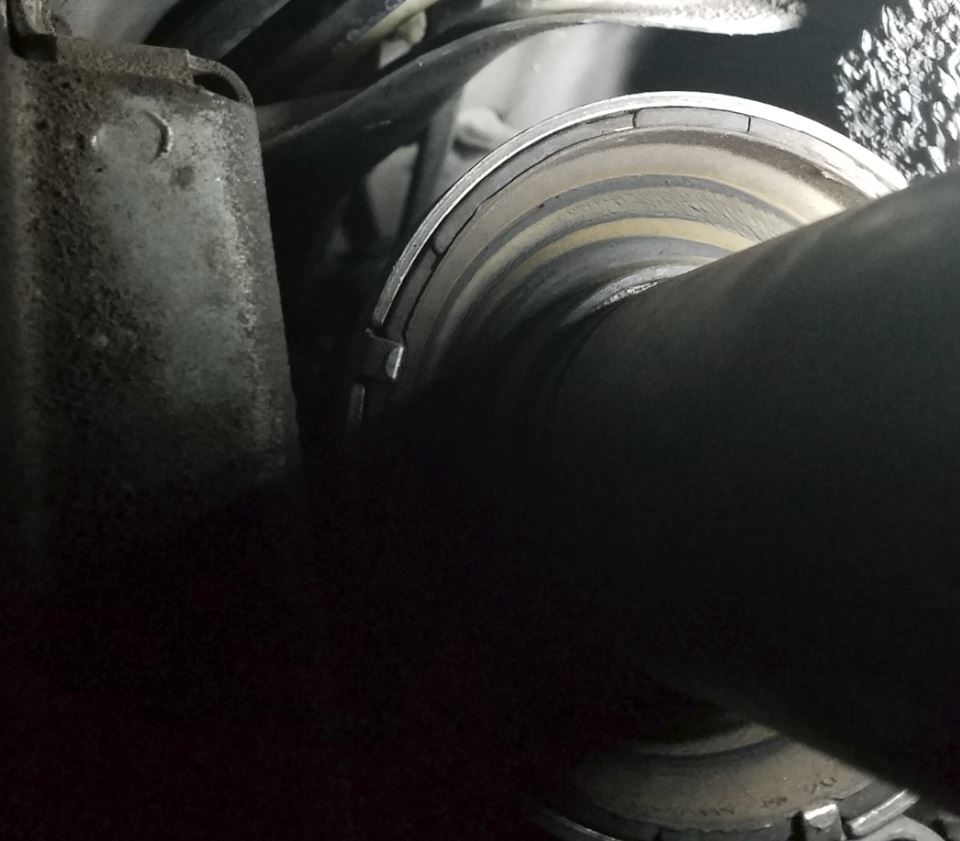

Thanks. Here are the damage pics of the flex disc, and the shape of the support bearing.
The shaft is moving up/down inside the bearing about a couple inches when I press hard with hand, but that's likely due to the bearing having rubber bushing.
Advice will be greatly appreciated since I am trying to get parts ordered before weekend if possible. THANK YOU.

If the centre bearing is ok then you could just buy this eps retrofit mount which means the whole cardan shaft doesn't have to be removed.
http://europeanpartssolution.com/products/porsche-cayenne-drive-shaft-clamping-bearing-support-mount/

Checked mine. Looks not good
You got some hair sticking out there too my friend.  I would check for cracks on that flexdisc.   Maybe time to get yours replaced before it affects the shaft.

Yes this is the eps kit mentioned above, just note this kit only replaces the mount it does not replace the bearing itself! If the bearing is worn or noisy this is not the total solution.
Eps have provided a tube of grease to repack the bearing which is prudent and in most cases this will work for many for years.
The sad point in this story: the driveshaft and flex disc was replaced by my indy last year.

1 hour ago, ekstroemtj said:
Shop called me today. Only the flex disc is gone. Rest is good. Service guy told me he changed and testdrive feels very good
Good news the cardan shaft is OK then.
