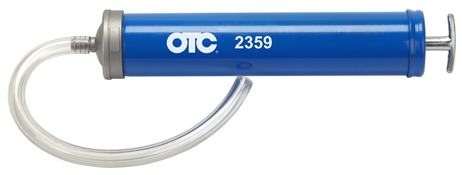

I assume you need to buy 2 quarts to fully fill the x-fer case since one may not be able to completely empty the container during the fill? Thx
I believe you would want to use a hand siphon pump (very cheap at auto store) so you can get it filled properly and probably one bottle would do, but I would like to hear from someone that did it to confirm.
Rated capacity is 0.85L. It pretty much sits mostly in the bottom of the chain case part until it starts moving then the chain drags some up to the top where it splashes around and lubricates the planetary gear and the clutch assembly.  I've found the Porsche capacity listings are pretty accurate (my engine takes exactly 10 quarts of oil- which is 9.5L (9.46353, but who's counting..)
One of these makes short work of getting every drop to where it belongs:  http://a.co/10ERX9J
I have two of these bought 10/15. Great tools. Also have the hand pump type that screw in the top of a quart container. I won't be changing mine to the new fluid for another month or so at the next oil change. I'll have 2 quarts handy in case I spill any. Will report findings then.

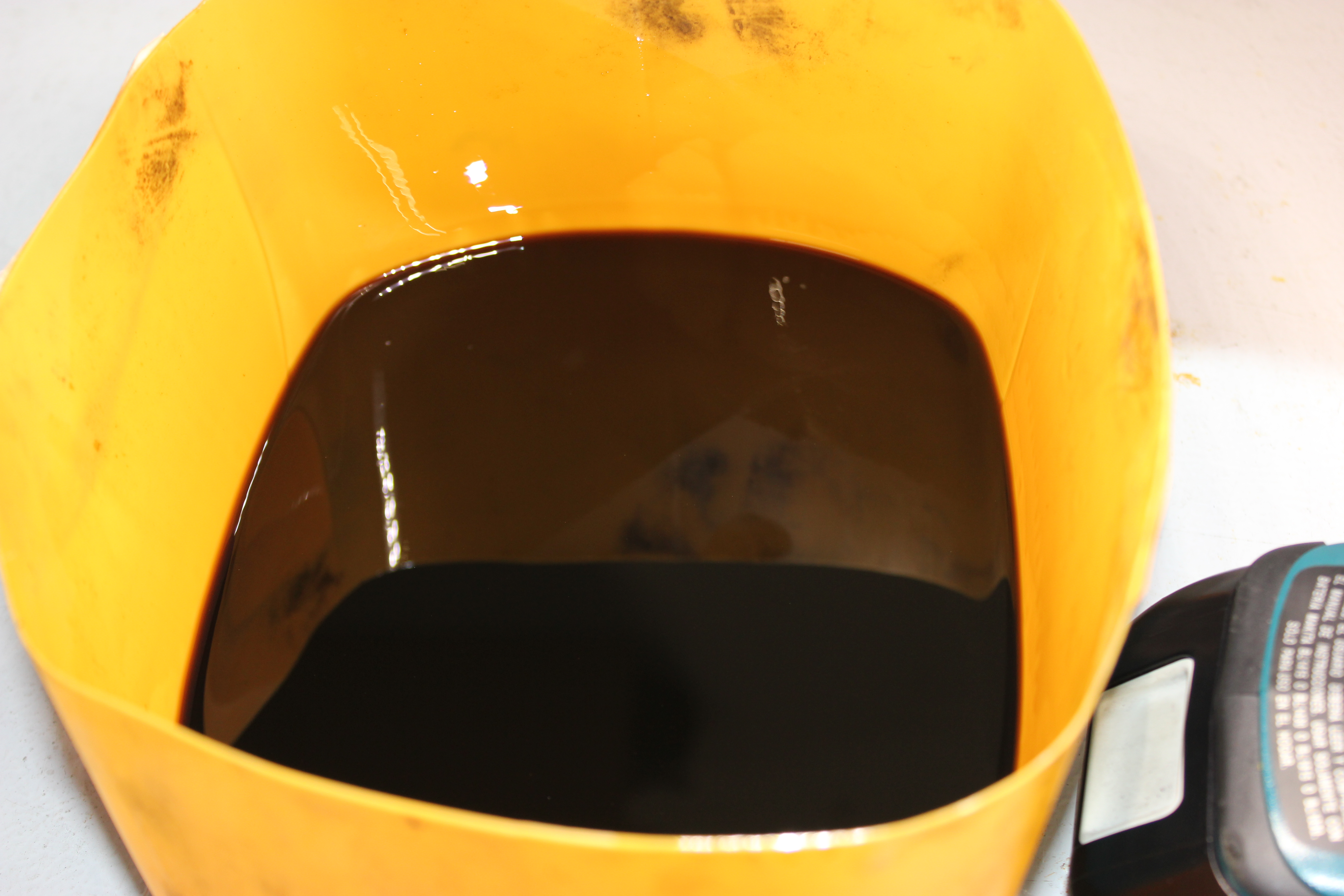

I just replaced the fluid in mine with Motul DCTF fluid.  Yes, I realize the transfer case isn't the PDK... The fluid is a replacement for Shell TF0870.
The fluid was definitely burned.  If you've ever smelled burned transmission fluid that's what it smelled like.  I took some pics as shown.  Looking at the oil I didn't see any metal flakes in it, indicating any kind of obvious metal wear.  There was also no indication of water in the oil.  It took a little over 0.8 liters to fill it back up.  Took it for a drive and so far, so good.  I didn't go very far but did drive long enough for the jerkiness to manifest itself as usual.  I'll post an update later this week.  Hoping for the best!
Just to be clear my local Indie shop used BMW X-fer case fluid in the change a few hundred miles ago, Vehicle mileage at 65K. I believe this was the 1st change. Regardless, at 70K miles, with the next oil change DIY, I will go with the new OEM fluid per Don's update. My fluid drained relatively clear with no abnormal smells at this time per the Tech. New "superseded" P/N fluid on order at this time.
