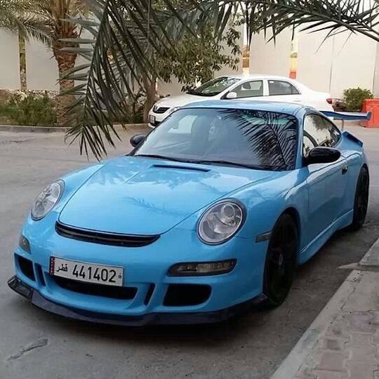

Hello , i own a porsche 996 carrera 2s 2001 model with 997 front end swap
the car originally has aautomatic, and my engine cracked down
so im planning to swap in chevy ls7 stroker 441 motor with t56 transmission with 648whp 610tq , ive seen couple of threads of people swapping in ls engines before

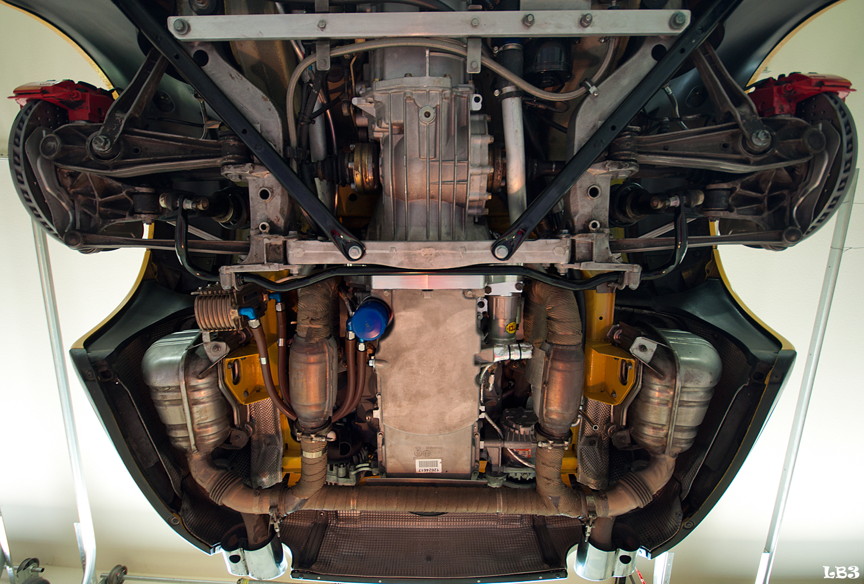

1)what is the diff specs
2) did any also swap in t56 transmission if yes where can i find transmission adapter to the oem diff
3) where to find an adapter from the diff to the engine

Wasfi ,  If you go with the stock rear end gears you'll leave all your tire rubber on the street, if you can afford it I would go with a 3:0 ring and pinion.  My car turns about 2,800 RPM's at 80 MPH, or red line 205 MPH.  If you don't change the ring and pinion you have too much HP for the low gears.
Renegade Hybrid in Las Vegas has the adapter housing and clutch assemblies to connect the 350 SBC to the Porsche transaxle.  I did all my own mechanical work, but the rub for me was mating the GM ECU to the Porsche instruments, etc.  I spent a lot of money with a couple of hi-tech guys to make everything work including the cruise control.  2 Things that still have a hiccup is the temp gauge and gas gauge.  I have a wide body car and the gas tank is configured differently, with a standard body car I don't you'll have that problem.  As far as the water temp gauge there is no fix for that, it will work for awhile, then quit, I reset it with my OBDII reader and it's good again.  I also installed a digital temp gauge as a backup.
