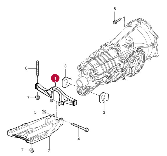

Thanks for that, but I think the part I need is the rubber part is in the rear of the transmission between the 2 pieces numbered '3'. Is that replaceable?
I am getting jerky gear shifts and rough idling. I already replaced the engine mounts which made a massive difference, but after driving a 20k mile version of the same car yesterday, I noticed my car has much rougher idle and gear shift.

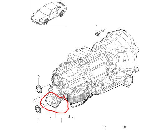

I'm thinking of replacing my 997 GTS PDK transmission mount as well since the car is 8 years old. I called Sunset and the person said that the mount (circled in red) is part of the transmission and not sold seperately.
So what happens if the mount is worn? Porsche can't possibly expect us to purchase a new transmission just because of the worn mounting right??!!
Will an insert work if the mount is worn/torn?
