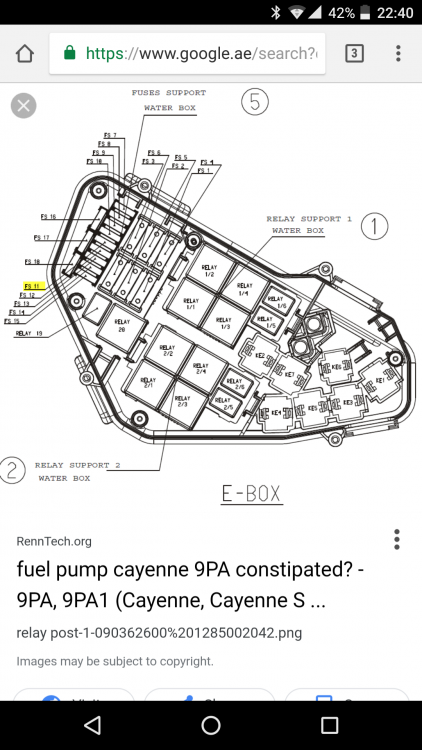

Left fuel pump weakness is quiet common!
Try switching to the right side pump (remove fuse for left pump and cycle the ignition and start) when tank is over 1/2 full, fill it up and see if it will stutter. The fact the last two cylinder on each bank was the issue before suggests fuel pressure and or flow is low hence the last two injectors on each bank are the lacking fuel. In theory anyway.
Also check your fuel pressure regulator is running at 4 bar during idle and revving. Should hold 3bar after 10 mins when engine is switched off.

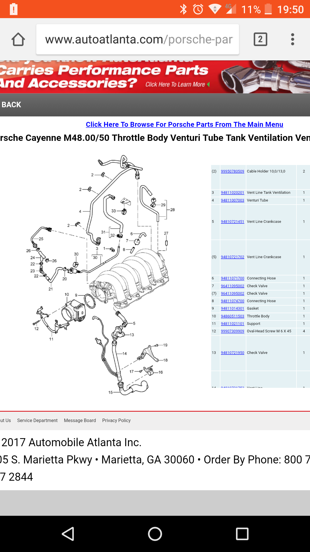

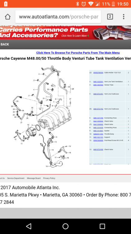

I had a quick look at testing the purge valve as suggested, but am a bit nervous I might break it removing the hoses. And as I don't have a spare I could render the car undriveable.
If I were to clamp the flexible hose at the front of the engine with a brake hose clamp next time it starts to stutter would this eliminate the purge valve?

Plugging/clamping the intake side rubber hose that connects to the purge valve might give you a positive result and would suggest/confirm a failed purge valve (which essentially allows a vacuum leak through the gas tank).
You can also use a soft rubber vacuum cap with a tiny hole drilled in it (0.5mm) to choke the amount of vacuum allowed through the valve. The cap can easily be installed on the intake side valve nipple, and then reinstall the rubber intake hose over both the cap and nipple. While this fix will help a failed purge valve, the car will generally run more smoothly if you just replace the valve.

I have now pulled the purge valve pipe at the firewall end and tested it as Lewis suggested. I cannot blow or suck through it.
