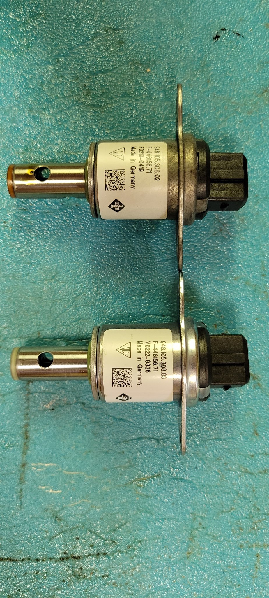

Replaced the valve lift solenoid. All is good now.

I suspect the valve lift solenoid. It looks like an easy enough job (which means I have obviously missed something).
Quickster2, did you do this yourself? If so, any tips or tricks to pass on?
