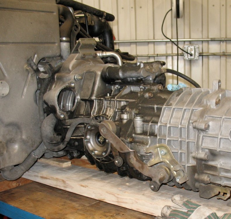

I can recommend Stan and Gbox, they rebuilt my 996TT gearbox.  If your mechanic has experience with this car pulling the gearbox it shouldn't be that bad.  If memory serves I paid my indy under $1,000 in labor to get the gearbox in and out of the car.
Regarding the second gear issue, are you aware of the detent?  You won't really know the synchro is worn until they get into the box and obviously the detent wouldn’t help in that case.  But if the case is otherwise, it's cheap and easy to install.  Just wanted to let you know in case it's the issue.
http://www.gboxweb.com/detent.html
I promise not to go off on a soap box diatribe but please, PLEASE, do not use anything but the OEM gear oil in this box.  Don't listen to the all people that say Redline and Royal Purple are the same thing.  Trust me, they ain't.  When you get Stan on the phone ask him how he feels about it........
