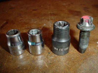

The back 2 bolts..... for starters. These bolts are Torx head bolts and need a torx or "E" socket to remove.

Sorry to dig up an old thread, but I have to send my DME and Immobilizer to Florida ECU doctors, and found that a size 12 6-point torx bolt (the 4 that gold the seat in place) is an exact fit for a non-metric standard 3/8” socket! So no special tools to get that E-12 bolt out.
