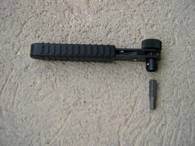

Success!!! The top screw for the coil pack on the middle plug on the driver's side was a bear. After taking what seemed like an eternity to get the socket cap screw out, I drove the company van to Harbor Freight Tools for something to speed thinks along.
I picked up a small 1/4" socket drive ratchet that cost $6.99 and comes with 8 bits. I spent another $2.95 for the 8 piece metric bit set to get the 5mm 1/4" drive bit.
The screw tightened in a flash using the thumb speed wheel. The top socket cap screws on the rear coils came out real fast with the 5mm bit once they were loose. You probably don't need the cheesy ratchet - just bust them loose with an allen key and pop the 5mm bit on the socket cap screw and spin with your fingers.

Tried to upload a picture of the cheesy tool but ran into problems...
Success!!! The top screw for the coil pack on the middle plug on the driver's side was a bear. After taking what seemed like an eternity to get the socket cap screw out, I drove the company van to Harbor Freight Tools for something to speed thinks along. This is what I found...
It's not on their website but cost $6.99 and it comes with 8 bits. I spent another $2.95 for the 8 piece metric bit set to get the 5mm 1/4" drive bit.
