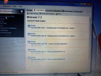

Ok JFP,
P1118
Porsche fault code 4-Heating power O2S behind cat. c. bank 2
P1117
Porsche fault code 14-Heating power O2S behind cat. c. bank 1
P1130
Porsche fault code 361- Oxygen sensing adaptation
idle range bank 2
P0139
Porsche fault code 17- Sensor aging behind cat.
conv. cylinder (1-3)
P0159
Porsche fault code 23- Sensor aging behind cat.
conv. cylinder (4-6)
Scott
OK, here goes:
P1117 & 1118:  Circuit resistance high on the sensor's heating elements, interruption in the heat circuits, interruption of the sensor's signal wires.
P1130: A/F ratio is rich at idle on bank 2, MAF signal issue, high fuel pressure, leaking injector, EVAP purge valve stuck open.
P0139 & 0159: Both sensors are not changing values as they normally should.
I would do the following:  Using your Durametric, check to see if one sensor on each side is show the normal voltage oscillations at idle.  As you seem to suddenly have sensor signal issues on both banks, I would be looking for a wiring issue.
