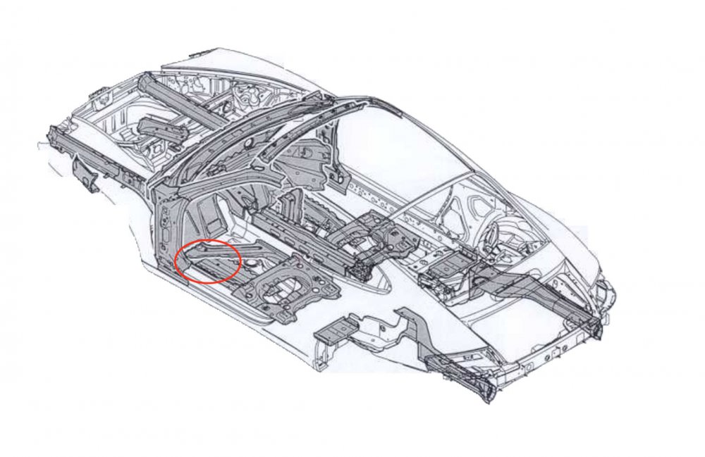

I have placed the jack many times at the area marked with the yellow arrow as per Pelican parts proposal. My problem is, that it is alway tricky to put a jack stand under the factory lifting points (green arrow) at the same time, since the jack is still in the way!
It would be much easier for me to lift more behind (e.g. red circle), but I am not sure, if this is strong enough (high strength steel?).
Has somebody tried to lift there? I am a afraid to damage the under car.
Thanks a lot!

Thanks for your reply!
When lifting at the rear jacking point, the car (front and rear) comes up only on one side.
With the jacking point in the pic both the left and right front side come up together, which is much more comfortable.
However the point in question (red circle) would make it again easier, since you do not block the way for the jack stand.
Therefore my question, if it is safe.

The liftbars are interesting when lifting the entire vehicle. However, for a quick lift at the front not convenient.
Actually the point marked with the yellow arrow ist strong enough and works very good. You only have to watch that the jack is not in the way to put the jack stand under the factory point. This can be done when you use the jack a bit "diagonal".
If the red circled point would be usable, you could put the jack more or less "blind" and straight under the car.I am not sure, but as per manual this should be also a carrying part made of high strenght steel.

Advantage of my described method is, that you can put both jack stands under the factory points at the same time with only one lift! The car stands stable like a rock. Doesn´t matter if use the yellow or red marked point, but the red would make it easier?

Looks like yellow arrowed area is double skinned (note seam visible where the overlap is). And red circle is further back than the double skin section, the floorpan will bend up if you jack on this imho.
Though you could jack on red circle if you use a spreader plank of ply, longitudinally along that frame rail which yellow arrow & red circle are both on..
