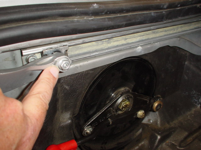

Can anybody detail their knowledge about the "slides" for adjusting the Boxster's clamshell? The two front corners of my clamshell are equally lower (not completely flush) with the rest of the car's body. Any suggestions? I was thinking of just yanking on each side by hand to try to get the front of the clamshell flush with the rest of the car. Thanks for the help.

I think what was being talked about above is what my finger is pointing to, a nut with a set screw. If you turn that screw you can move the clamshell up and down a bit.
Tool Pants,
On my car, the area of the set screw feels wiggly. Like it's a somewhat loose, is this normal? Or is this area supposed to have little to no flex? I can easily push the clamshell side to side when it is in the air, don't know if this is normal. Thank you.
