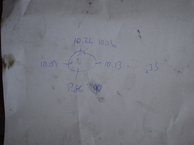

Well, since I know Gary, the owner of the car, and Peter the shop foreman who replaced his engine, and Dennis who is the director of service and parts at Stevens Creek Porsche.....
And since Gary has plastered the message boards with pictures of his old and new engines. But not on RennTech.org. :P And he picked up his car yesterday. And since his pictures had the Snap-On roll-aways used by mechanics Peter and Manny who work at Stevens Creek Porsche in the background. I knew where to look for his sheet.
And since Gary took 1/2 hour away from our tech session at Stevens Creek in April so that his Q-tip session could start at 10:00 am. :angry:
And so....
I will let Gary explain. :blink:
What do the numbers mean? Seal bore? Concentricity? Obviously out of round?
thx...
Jim
Jim:
The picture shows the measurements from the outside surface of the crankshaft/flywheel mounting flange to the inside of the crank opening in the case. Take 4 measurements and the difference can be no more that .30. In my case the variance between the top and bottom of the case was .36. If it is more than .30, then replace the engine.
thx...
Jim
Jim:
Thanks to the court complainer & service bay stalker for letting me clarify this.
:clapping:
thx for the explanation. Got it...
