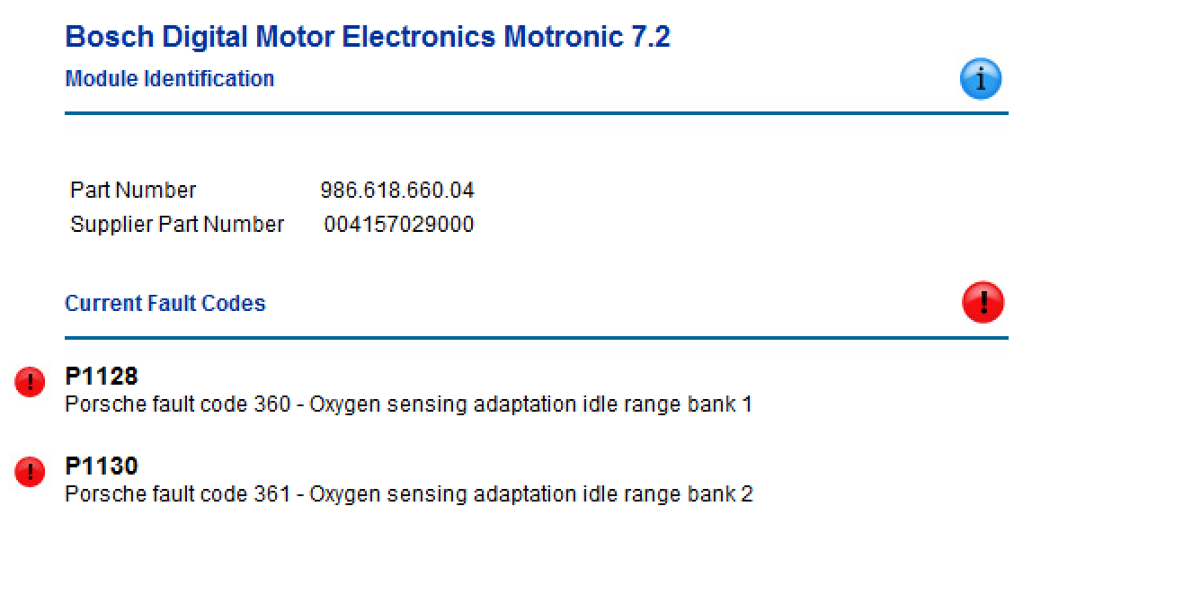

Need help with 986 troubleshooting - rough idle, etc.
Yes sir, thats the lesson here and I thank you for teaching/reminding me that.  I'm an IT guy by trade and I understand the troubleshooting process with everyone else's stuff except mine.  Understand neither of us have a crystal ball but does it make sense proactively to change the other two 02 sensors?  Not for age but for time seeing the car is close to 20 y/o.  When I took the PC sensor out the tip was white as a ghost.

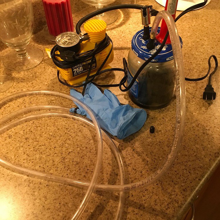

I have the same codes on mine. I made a pickle jar DIY smoke machine. Worked GREAT and cost about $8 including the pickles but I already had some items laying around.
Search youtube for instructions.
I made a couple modifications: Instead of bic pen I used two tire valve stems ($2/pair). Drill 1/2” holes for the valvstems and the soldering iron. Remove valve core on one of them and 1/4 hose fits on perfectly. I used $6.99 12v air compressor from harbor freight. Pickle jar I upgraded from 24oz to 32oz to have a wider lid. Use rubber glove with pinkie fingertip cut off to attach to 1/4” hose and adapt to the large intake hose by the throttle body (have to remove the hose between throttle body and MAF. I used hot glue to attach the soldering iron so I could remove it later and because it was faster/easier than epoxy.

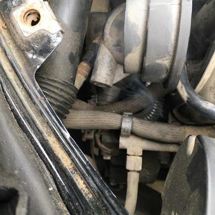

I believe I found my leak is the bellows under the AOS.
Hard to believe but this works perfectly. I whipped it up this morning and was smoke testing within an hour. Haven’t had a chance to do the repair yet but I think I now know the problem.
