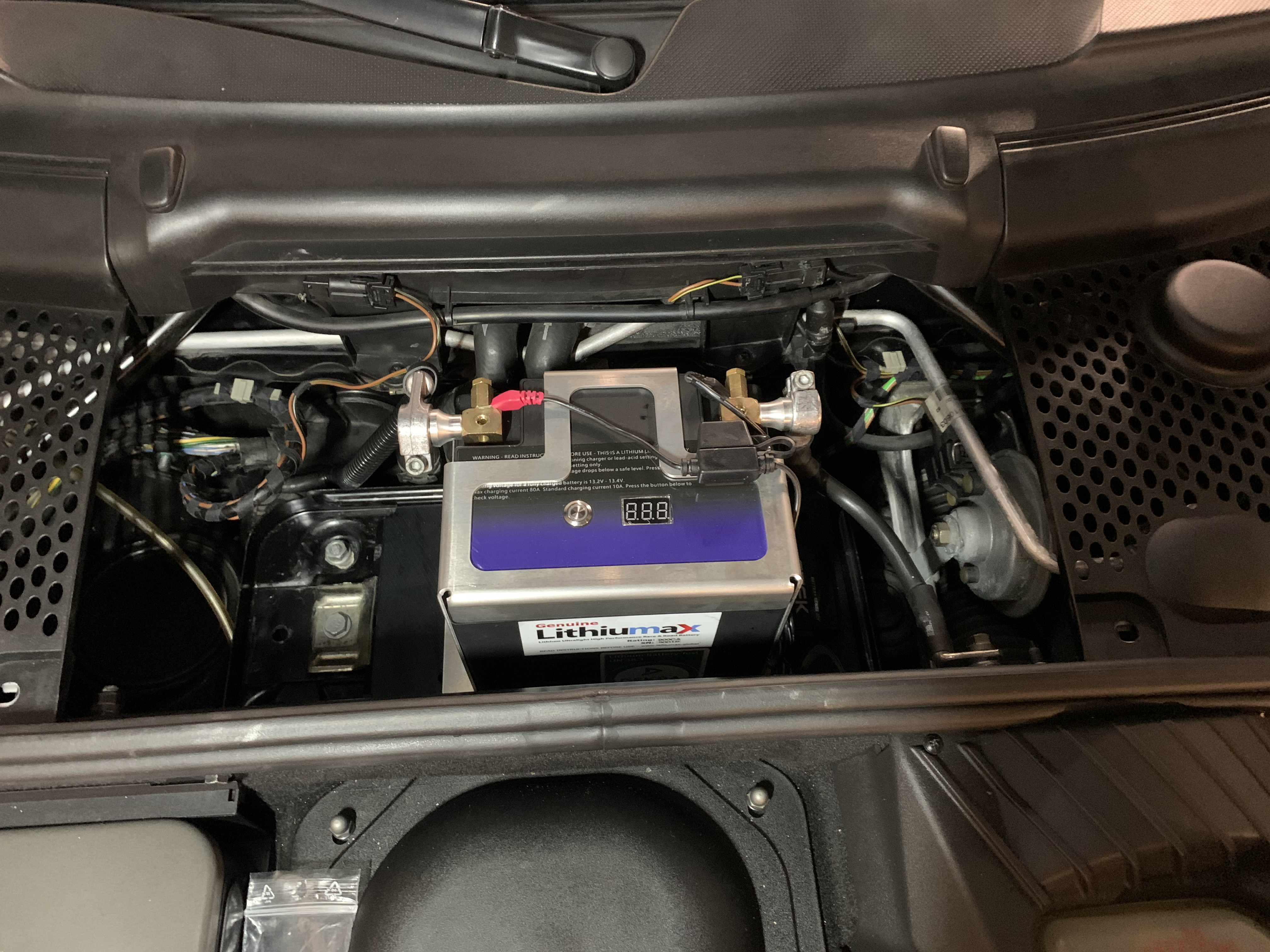

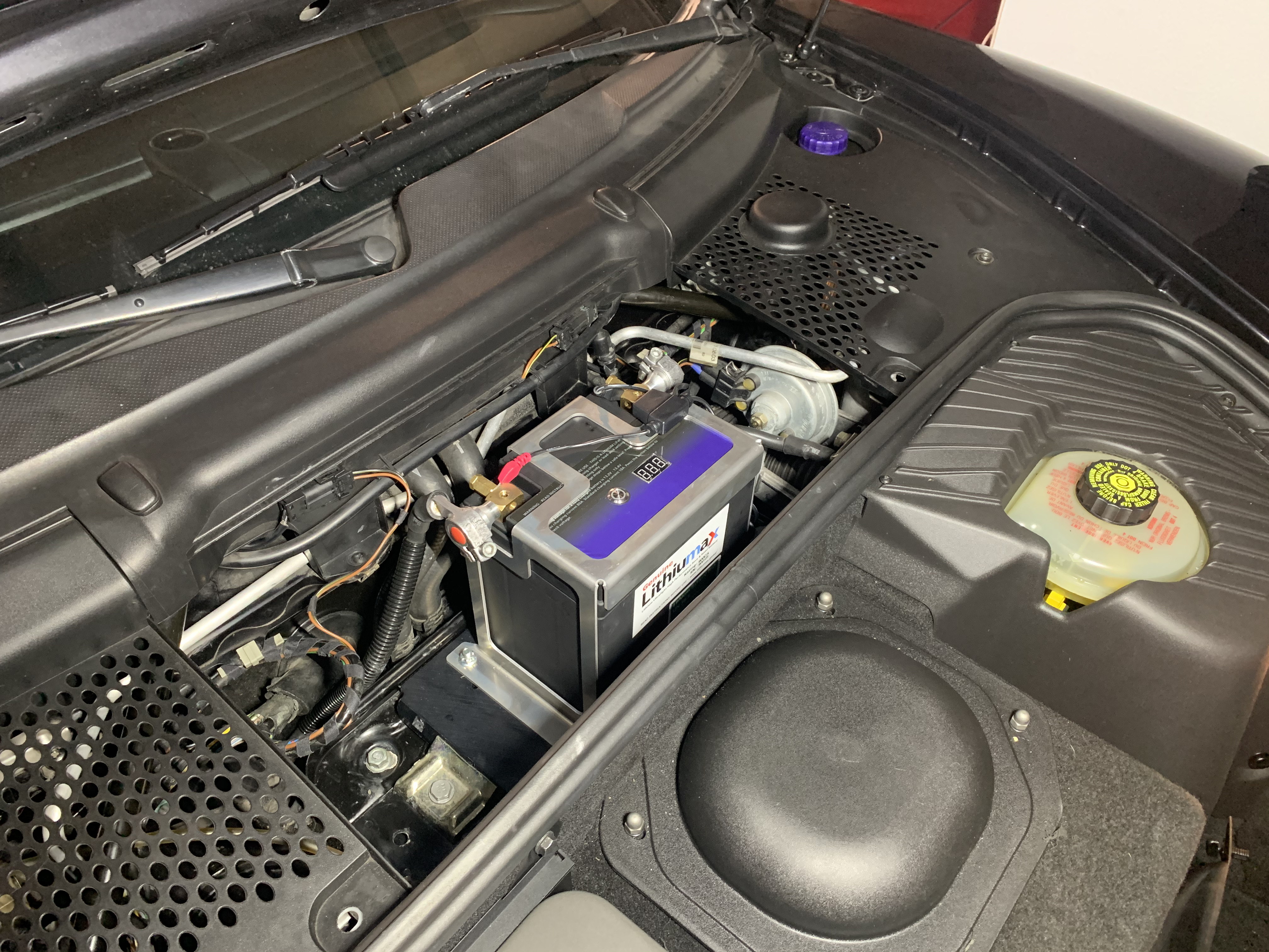

And here it is, already installed and working just fine:
Looks awfully empty in there.
I guess I have a little bit more of frunk space now 😉

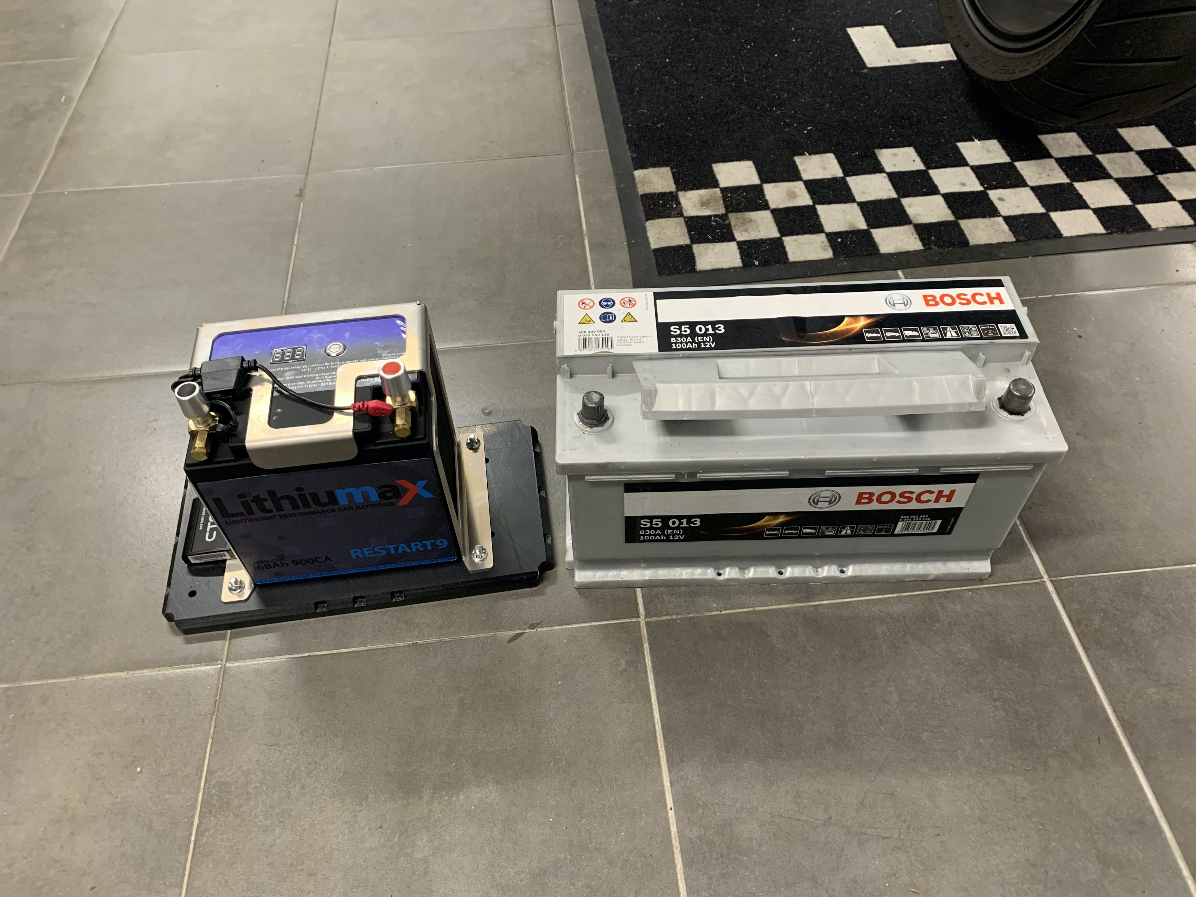

The size comparison is amazing as well as the weight: 26kg the Bosch, 3.3kg the lithium. Considering that I replaced the comfort full electric seats with the 997GT2 seats, and saved about 40kg there, I managed to offset the weight of the Tip when compared with the manual 😉 Disclaimer: neither one of those mods was done to save weight, it's just a positive side-effect.
I bought the Bosch about 5 years ago and it served me very well but it was no longer holding a charge and I had to have it on the tender overnight, going to sleep with 12.6 and waking up with 12.2 if off it. After a couple of days not running and off-tender, it was down to 12V. It was still starting ok but I guess it was a matter of time and as I hate being left stranded, decided to replace it.
